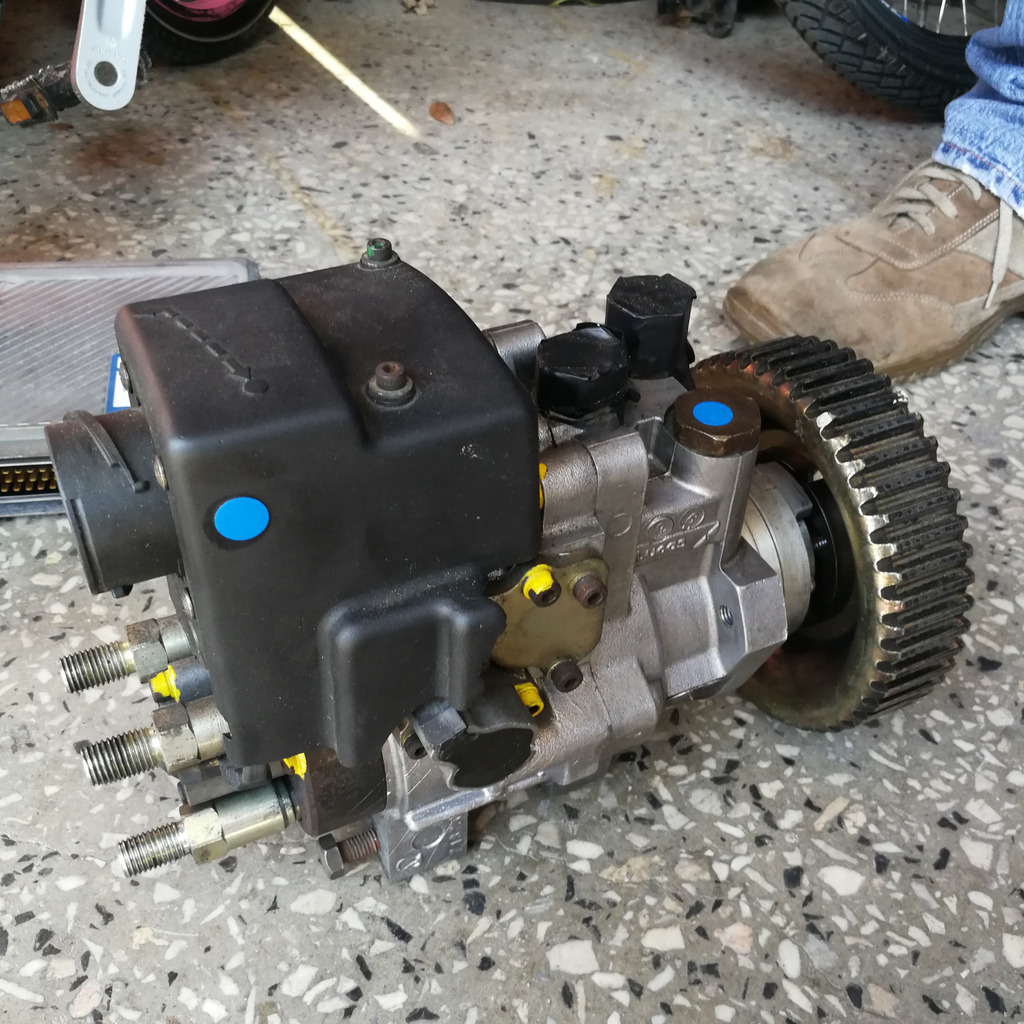

With all those codes I would look at the multiplug on the back of the fuel injection pump, the round plug that goes into the back of the black box in this picture.
