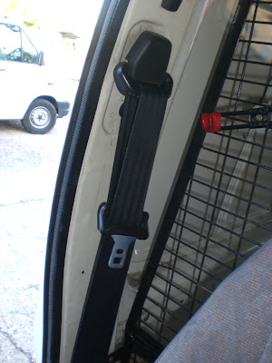

Hi,
Pulled by VOSA today and the only problem they found was a frayed seatbelt on the drivers seat...
I've got a new one (already removed by the scrappy) but where am I looking to change it over? Can just see a few torx bolts... :?
5 Series F10 BMW. Factory standard. Pokey ;)

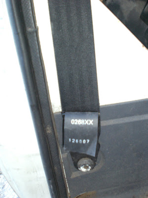

That's it. Just those few torx bolts. Remove the plastic covers
There is one more behind the seat on the door pillar which I haven't got on a picture.
Undo all the torx bolts (three of them I think) and little bit of wiggle to get the mechanism out of the door pillar and you're done :!: :wink:

Bingo! Cheers Nad :D
I thought that's what it was but wanted to check first, I don't want to be fishing bolts out of small places :lol:
