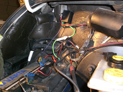

I wouldn't normally recommend halfrauds, but they do a nice quality charging kit, with all the heavy cable, fuses etc. to do the job in the caravan/camping section. I fitted one to Nada's van recently, much better quality than mine, but if I remember rightly, it cost about £14 - 16. Has the auxcillery output too.
But you being a towbar fitter would have in the back anyway :lol:
