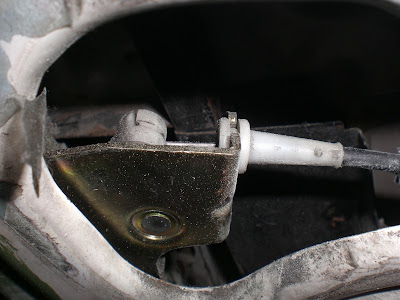

It could be just this wire slipped out of the lock assembly :idea: Take the door card off and see if it's connected as it should

I think it will open if the plastic on the assembly is broken or it slid out of it's place (the one on the right on the second picture). The wire would still be connected onto the assembly at the end allowing it to open the doors, but it would be impossible to lock it with the handle. :D I'm just trying the simple solutions first... :P :lol: :lol: Before someone comes on with better answer :mrgreen:
