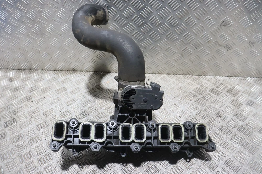

follow the booster pipes its the first thing before the manifold
this gizmo here in the centre of the picture with black plastic cover on it
https://i.ebayimg.com/images/g/6xIAAOSw ... l1600.webp
thats actually a mk8 2.2 in that picture
this one advertised as a mk7 looks the same
https://www.ebay.co.uk/itm/167346573989?
all the best.mark

Nick_B wrote:I had my dpf cleaned on Friday. The guy couldn’t make my van do a forced regen. He said it’s an issue with the throttle body.
I’ve looked all over on the engine to try and locate it but can’t see where it is.
It’s a ford transit mk7. 2013. 2.2 front wheel drive.
Can anyone tell me where the throttle body is located?
On the FWD's it on the inlet manifold. Only the Euro-5's have the throttle body, why they have one is anybody's guess.. :?:
#9F926 here:
http://www.catcar.info/ford/?lang=en&l= ... NSsxMzM%3D
