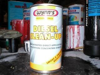

Postby gemini » Tue Apr 04, 2006 5:16 pm
try some of this, or forte, get the engine hot pour it straight into the filter then top it up with diesel, take it a good run, if it is still the same after its probably an injector at fault
