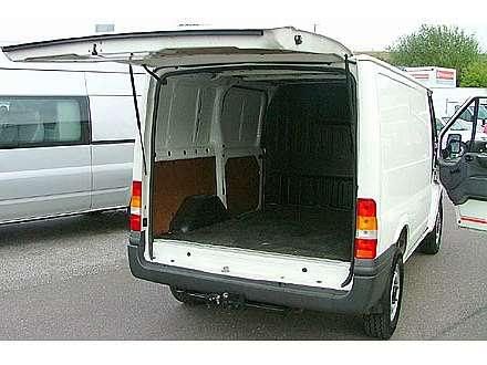

Hi guys great site , i'm sure this is the place to find the answers to a couple of questions . I'm currently running a T280 and it's come to the end of a very useful life as my works van . Rather than outing it i'm thinking of keeping it for personel transport with a few mods and wonder if the rear axle from a rear wheel drive would bolt straight in or if not does any one know what would be involved . I realise theres no transmission tunnel but the new engine will go in the back with a short prop to the new axle. The other question is what is the most powerful transit in production BHP? . thanks .

Can't see why it wouldn't fit as they do make T280 RWDs :D

Just had a thought :idea: :( You might not be able to as the floor level is too low :( :(
But it sounds as though you'll be doing a bit of cutting out anyway :lol: :lol: :lol:

I never new ford made a rear drive axle model of this style van , Is it the semi- high top with the higher floor . I recon it'll stand the extra power if i keep to standard wheel widths

Postby AndyG » Wed Jun 07, 2006 7:47 pm
Higher floor :!:
Look :!:
Uses the 16" wheels :D
