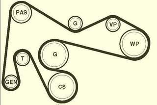

Hi
I have a 2.4 x reg transit van and the drive belt idlers siezed and snapped the belt, i have new belt and idlers but dont know how to put the belt on, does anyone have a diagram or a photo so i can see how to route the belt, please help dont want to pay to get fitted because belt and idlers cost over £200 from ford
Thanks dave :?

Postby MrMPuk » Mon May 22, 2006 10:40 pm
With or without aircon?

Postby dave355 » Mon May 22, 2006 10:44 pm
Hi
thanks for quick reply it does not have air con

Postby motorwise » Mon May 22, 2006 10:46 pm
try this
Image[/img]

Postby MrMPuk » Mon May 22, 2006 10:46 pm

Postby motorwise » Mon May 22, 2006 10:53 pm
MrMPuk wrote:Image
snap - sorry :D

Postby MrMPuk » Mon May 22, 2006 10:55 pm
Must have been typing at the same time, I only asked as I have the A\C diagram here as well.

Postby motorwise » Mon May 22, 2006 10:57 pm
MrMPuk wrote:Must have been typing at the same time, I only asked as I have the A\C diagram here as well.
at least they're both the same :D
