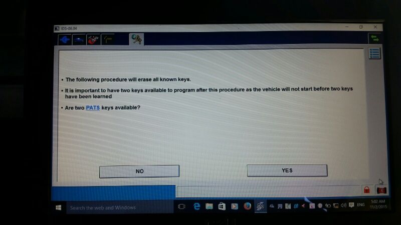

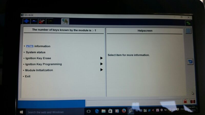

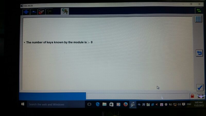

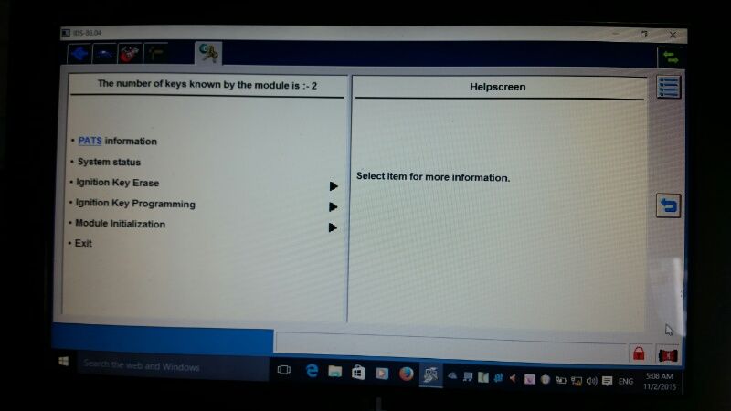

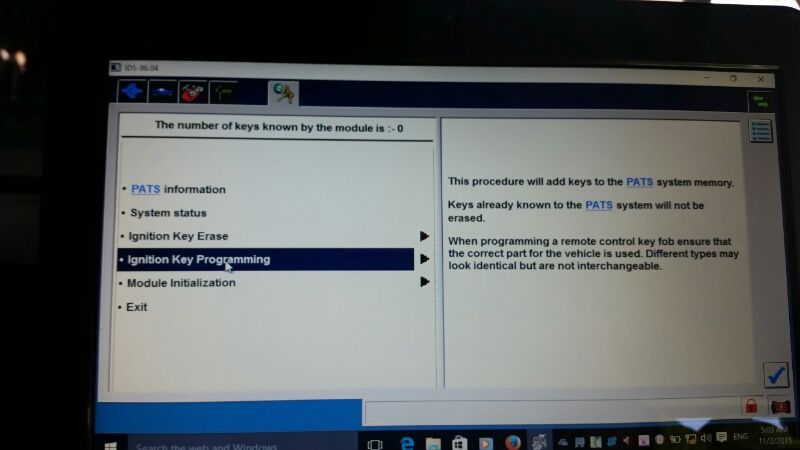

Postby loot » Mon Nov 02, 2015 2:24 pm
Erased all known keys.
Only key in the ignition and turned off, programming key ids gets coded access to tis.
Get incode.
Remove the Key from ignition and put back in.
Only key is coded, key out and back in and start the van to check :-)
Key 2 coded as above (if done straight after first key you don't need coded access but since i closed the operation i had to get coded access again.
I did get a dtc saying less than minimal keys coded but it cleared fine and didn't hinder the operation.
Only reason I've gone to length to show it can be done is because if for some reason you find yourself in the same situation then you know you can get it done without panicking about getting a second key.
Also works on module replacement ie pcm/bcm.
I do recommend having 2 keys tho as you can't go wrong with a spare key. :wink:

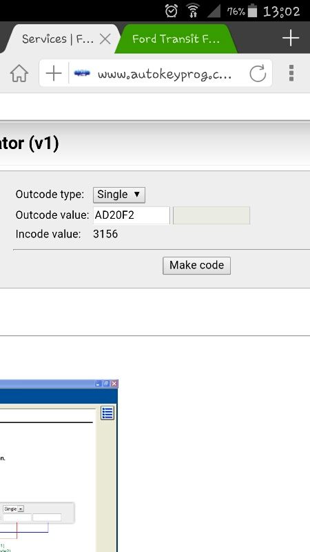

Postby loot » Mon Nov 09, 2015 9:00 pm
You need incode every time you enter pats programming.
You don't need ids online to do it, you need internet on your phone/other laptop to generate the incode to then input to the request screen in ids.(you can note down ids outcode then run to your internet for incode then back to your van if using Wi-Fi) i just use my phone tho :-)
The timeout is after this part which is just when you remove the key and put the key back in then press tick to program key.
