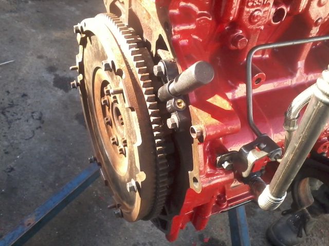

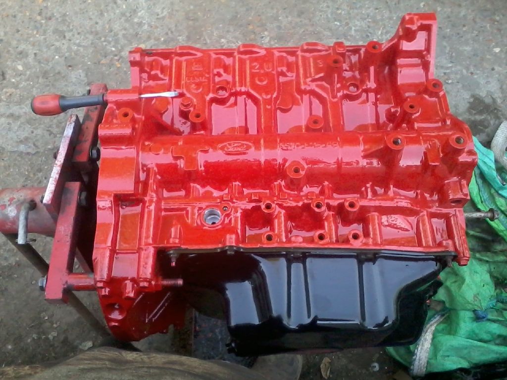

Postby dieselhead123 » Wed Nov 02, 2016 10:52 pm
Been recording some more progress on this and notices the pictures of the nice red engine have gone :shock:

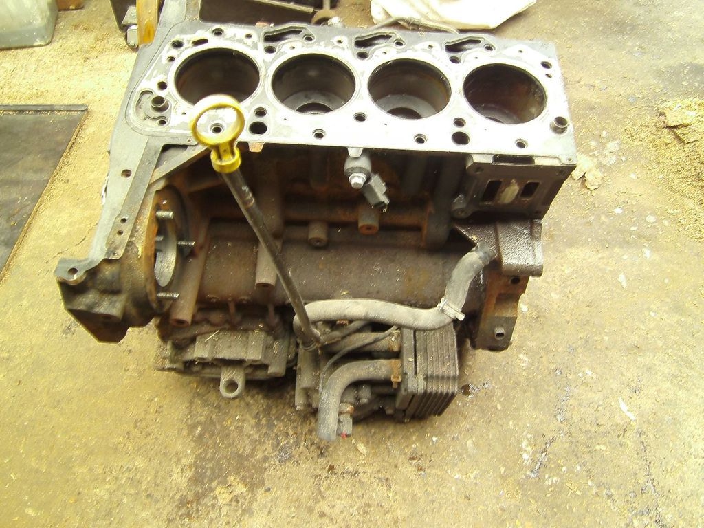

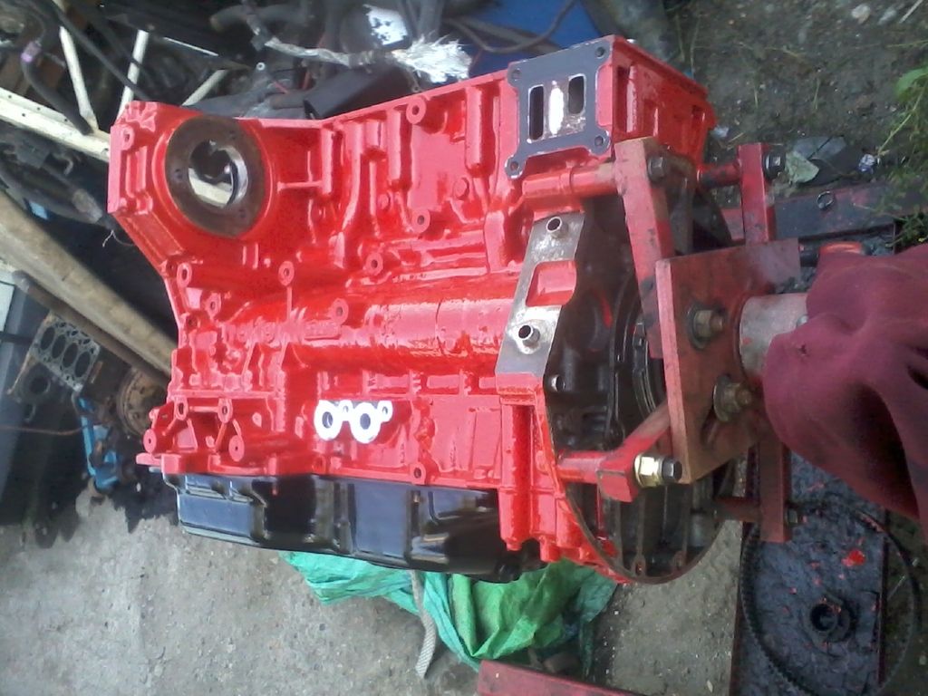

So, we started with this, just a 2.2 block as we needed to fit a Tddi head;
Painted it looks like this;

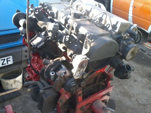

Then we fitted a 2.0 Tddi head to accommodate Tddi injectors, the 2.2 uses 'short nozzle' injectors, to use Tddi injectors, (long nozzle), we needed to fit a 2.0 Transit head'. Over the last few days Jay has been assembling the rest of the engine;
A 2.0 Tddi flywheel was fitted;

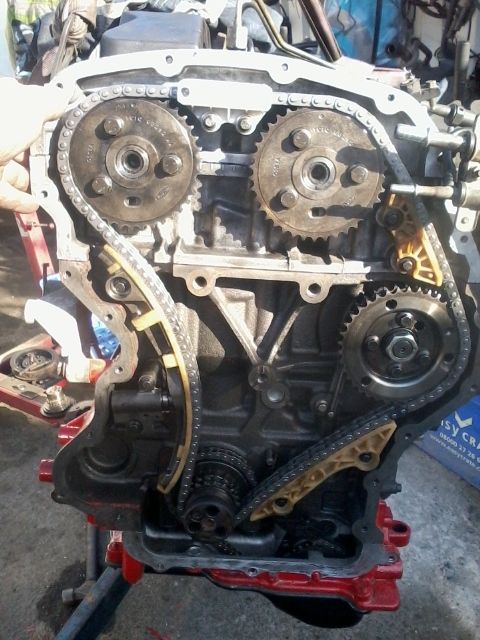

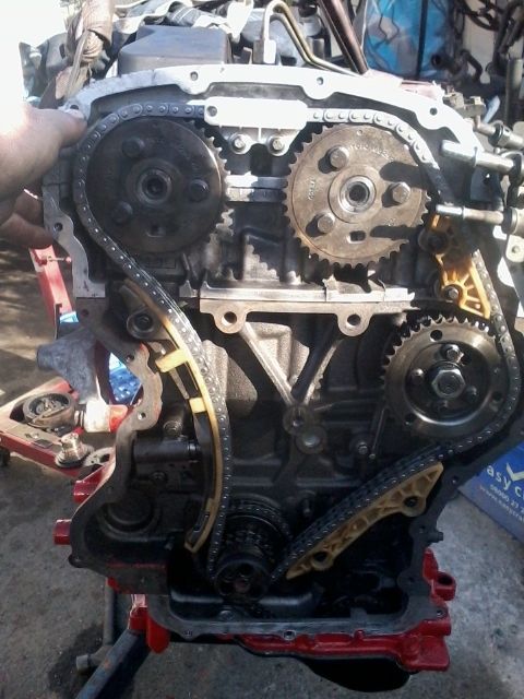

The wider 2.4 115ps chain kit and matching sprockets were fitted;

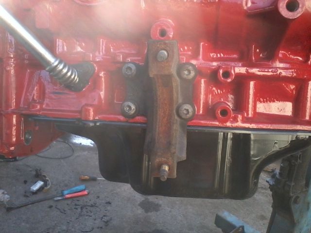

The Transit drive shaft support plate was installed;
Jay also fitted a 115 Tddi Mondeo turbo, a readily available and low cost unit, we have had good results with these on our front wheel drive conversions.

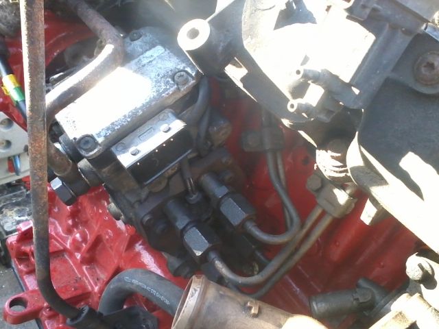

But what have we here?

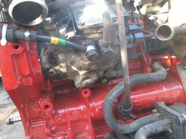

Looks like a Vp44 injection pump has been fitted to a front wheel drive engine :shock:
Will it work :?:
Posts: 3514
Re: Fitting a 2.2 engine into a Mk6 FWD
Postby paul2012 » Thu Nov 03, 2016 12:54 am
Will it work :?:
Nothing new there.....
2000-2003 Mondeo mk3 115ps TDDI (D6BA)
Bosch VP44 - 0470504035
Ford Part no F1345068 (1S7Q-9A543-AE)
Didn't you know. Mondeo mk3 TDDI's also had VP44 pumps :wink: 8)

Postby dieselhead123 » Thu Nov 03, 2016 9:15 pm
Hello Paul, the pump Jay has fitted is from a 2.4 115 Transit, but it would be interesting to see how the 'make up' of this compares to the Mondeo one. Unfortunately we don't have a Mondeo pump, (or PCM), to try so this will be tested with a 115 Transit PCM. We have an 8CAD to try.
We expect this 'parts permutation' to work well, but we like to try different parts with our front wheel drive conversions just to see what works best. We did try a Mondeo Tdci 130 VNT turbo, with the vanes held fully open :!: Performance was good, but ideally we needed an external waste gate :shock:
One thing we have noticed with the VP30 pump equipt front wheel drive conversions carried out to date is that they all run well with either 85 or 100 FWD software, but as soon as you replace the PCM with a 90 RWD unit they seem to exhibit a slight 'misfire' :?
I discussed this with another member at TM this year, unfortunately we reached no conclusion. Have you any idea why this might happen or come across similar 'happenings' with PCM/software swaps?
Thanks for your help and interest,
PS. We only swap 'late' for 'late' PCMs because of the 'cluster f@*k' that occurs if you 'mix and match'.
