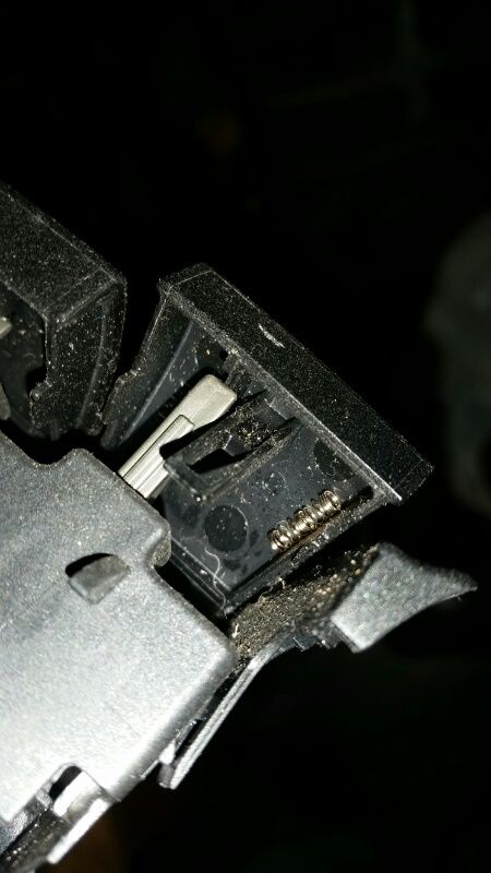

Was thinking the other day that when it's dark you can't see the cruise buttons :?
Or is it just my wheel that's dodgy :?:
Come on Loot, surely that would be right up your street to sort out :wink:
T330 RWD now sold
Ford Ranger Wildtrack now sold
MI 5 sacked me from my job as an interrogator this morning, didn't like to ask why :?
Tango330
Posts: 3084
Joined: Mon Oct 14, 2013 7:53 am
Location: Deepest Dorset
Re: How to add factory cruise on a mk7 transit+pics
Postby loot » Wed Mar 18, 2015 10:43 pm
No lights on the buttons, there's a spare terminal pin on the squib and if you are brave enough you have 2 more on the 2nd airbag pins (unused in ours)
You could add 12v if brave enough, or possibly 2v if that will power some small smd leds(possible mod of resistors)
Then you need to skim the back of the buttons enough to show light through the white paint.
That should do it :-)
I've got the mk4 Mondeo steering wheel that has illuminated buttons but it is a lot of work building the resistance ladder for cruise on the switches to copy the transit button switches (on pcb possibly going to make some myself when i have time) :mrgreen:

Postby loot » Thu Mar 19, 2015 9:02 pm
Well it's 10 pounds an hour in my head but i end up with much less when members come round :lol:
Not 1 person has brought biscuits though :cry: :mrgreen:
I have thought about the buttons and I've decided that shining a light through the top/white bit and using a dremel under side it should be possible to file away till you see light, then maybe some hot glue to strengthen it when finished and all is good, only thought tho is if there are tubes under there to press the buttons, in which case........ F*ck :lol:
I'll have to have a see :-)
07 350 170ps
Ids map here
loot
Posts: 33977
Postby loot » Thu Mar 19, 2015 9:09 pm
Plan B then i think.
