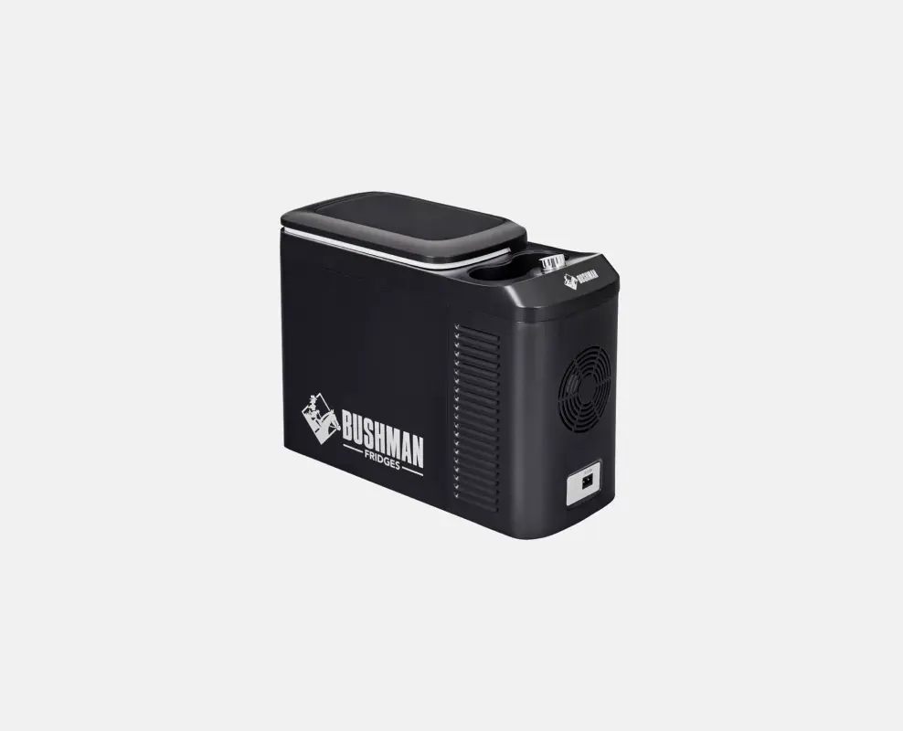

I fitted a second battery under the drivers seat and had a Redarc safety switch and the necessary cabling installed including an Anderson plug outlet.
I now have a a Bushman Traveler fridge/freezer between the seats :Image

Oh and the dual battery set up with safety switch ( it disconnects the front battery that runs me fridge freezer when the motor's not running and also cuts out when it reaches a certain voltage. I have 2 x 80 amp batteries, I think... The fridge will run for about a day and a half on the battery alone. If I drive every day even like to the shops or something I can leave it run full time. I currently don't so I turn it off. But if I was going somewhere, I can turn it on the night before or even just crack it to minus 16 and in an hour or so I could wind it back to minus 5 and keep drinks, water and food cool. Which is nice. It fits between the seats like it was made for the job. I don't really require a big fridge that'd have to go in the back because it's not a camper. I can use it as such but I can also haul my bikes or whatever at a moments notice.
