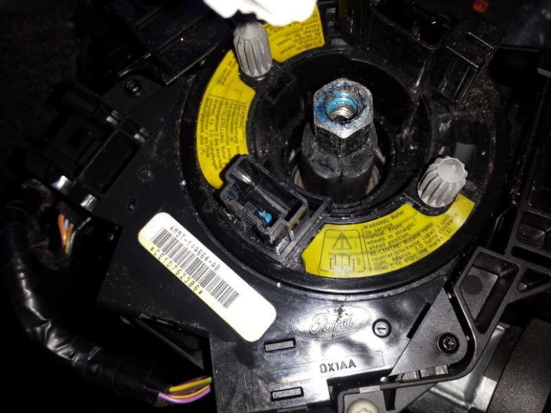

Yes that's how every one of them seems to be, ignore that connector, your wheel wires are fine so it can go back together.
Next job is to find out if you have the cruise wires on the underside of the squib, the photo is further at the beginning of this thread. I think you'll have them so next is temp sensor is installed and you'll be ready for martyn to activate.

Re: How to add factory cruise on a mk7 transit+pics
Postby loot » Wed Feb 19, 2014 10:32 pm
Rumble bee wrote:Found two cruise steering wheels for £60 each if anyone wants one?
Did you look at your squib Chris? Dying to know if you have2 connectors for it lol
Postby Rumble bee » Wed Feb 19, 2014 10:37 pm
Just sorting a pic out.
And no there is just a blank connector, no pins.
Found something odd out to about the door open / door ajar too.......
Rumble bee
Posts: 2529
Location: Manchester
Postby loot » Wed Feb 19, 2014 10:57 pm
So if there's only 1 connector then why all those wires? Major confused now lol

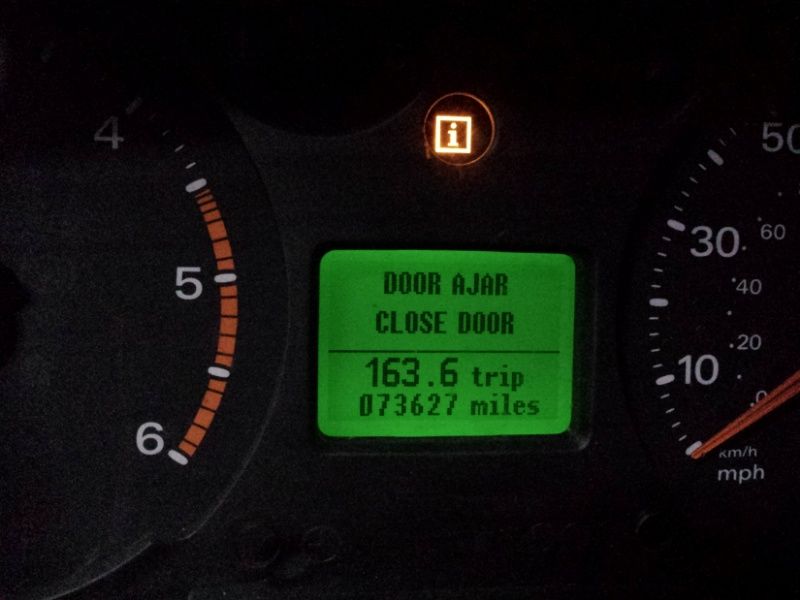

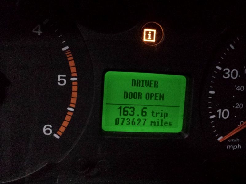

Postby Rumble bee » Wed Feb 19, 2014 11:16 pm
My squid,
Door open,
Press the horn several times quickly,
Ta da, door ajar
Postby loot » Wed Feb 19, 2014 11:18 pm
Eh? Does it change back?
What is the blue in the lower connector? Same squib part number as mine i think tho but mine is just black and empty but i cansee blue in yours?
Postby Rumble bee » Wed Feb 19, 2014 11:21 pm
Yeah changes back :?:
Looks like a drop of lock tight from the steering wheel nut
Postby loot » Wed Feb 19, 2014 11:22 pm
And also, why were you pressing the horn like mad? :lol:
