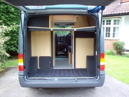

Has anyone ever experienced a water leak into the o/s/r floor around the wheelarch?
Ours is fully trimmed out and the carpet gets sopping after use in the rain, but the trim material on the sides are bone dry, even the bit adjacent to the damp floor. We have the large single hatchback type door which will drip water into the area on both sides when open, but this drenching happens when the door is shut.
The rubber seal to the door opening on the o/s looks as if it isn't seated as well as the n/s and I wonder whether that might let in water although it looks more like it's coming in from underneath the floor somewhere.
Any thoughts welcome.[Image]

Postby steamdrivenandy » Fri Feb 16, 2007 11:57 am
I was wondering about that.
If you look on the photo the o/s seal adjacent to the bottom of the rear light cluster doesn't seat as well on the metal gutter/joint as on the n/s. I've tried to ease it on further but the bulk of the trim on the inside makes it difficult. However when you inspect the seal after rain there doesn't appear to be any signs of moisture on the closing face of the seal. which I guess you'd expect if water was going passed it. Difficult to know at this time of year 'cos it's just not warm enough to dry out the carpet.
