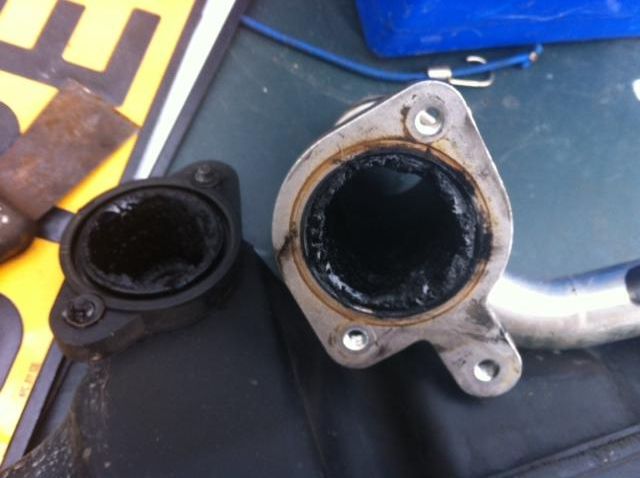

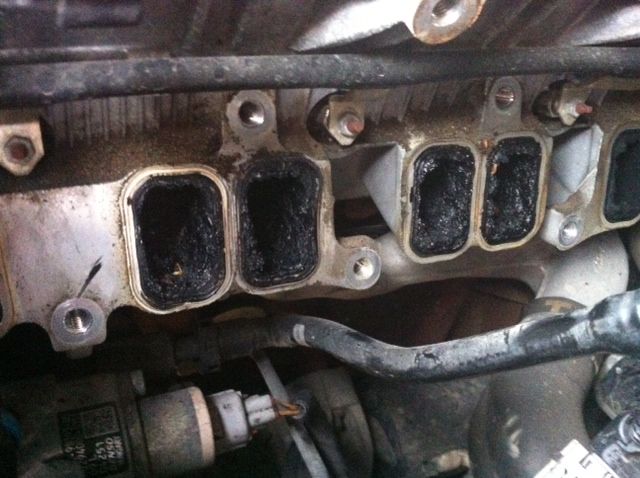

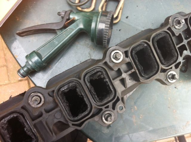

Postby blue estate » Sun Oct 06, 2013 1:54 pm
Take the manifold and pipe off clean them and blank the Egr as the gunk is soot mixed with oil also use new seals
You'll see why I said to clean it when you see how blocked it is
This is my inlet manifold and my van is a 2010
My egr is now blanked and the pipes are as clean as when I cleaned them in may
