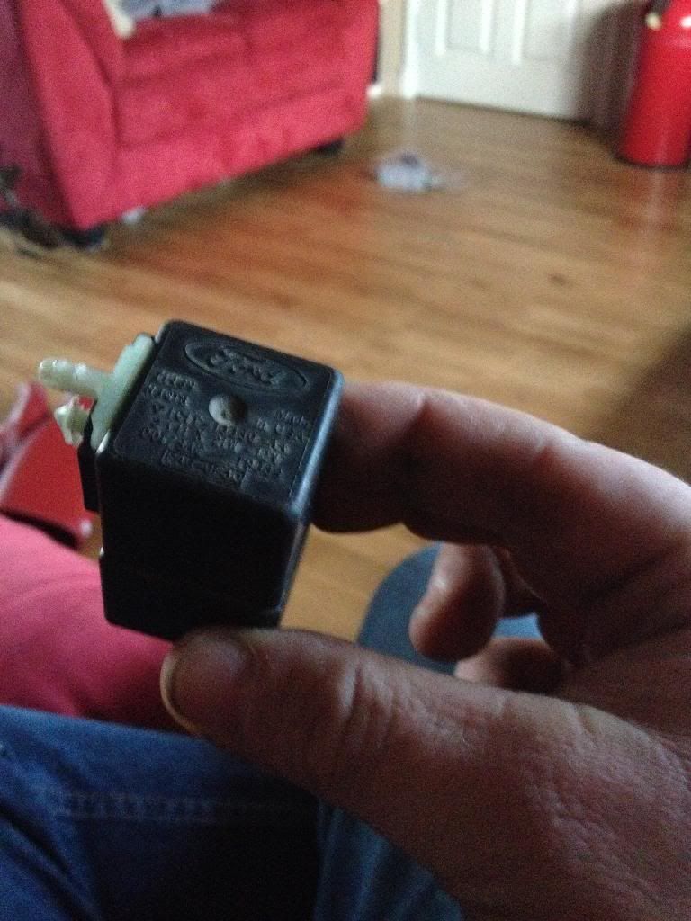

Postby Punto443 » Sun Dec 29, 2013 4:06 pm
Is it one of these?
If so I've got a spare you can have :D

Postby Jamysumm » Tue Dec 31, 2013 1:29 am
Punto443 wrote:Is it one of these?
how many pins are on yours bud

Postby Jamysumm » Tue Dec 31, 2013 1:34 am
my mate says he'll take it ;-) cheers for that
