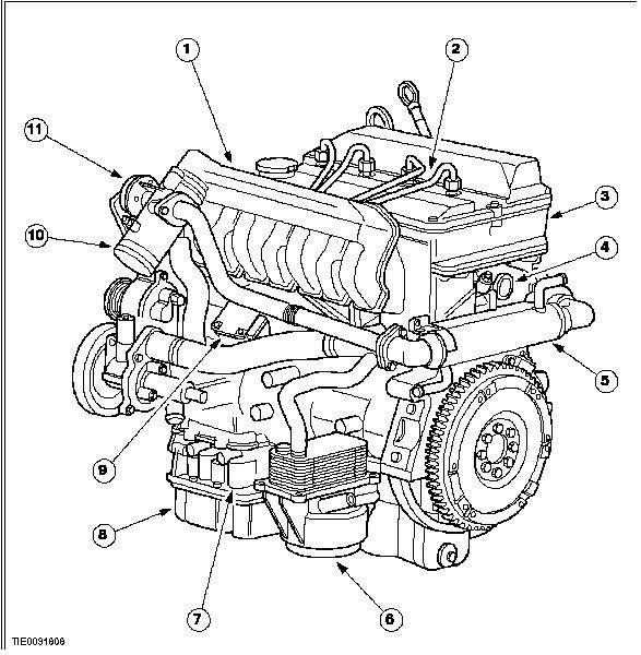

Postby Guy88 » Sat Apr 07, 2007 8:02 pm
This may help :wink:
If its No.7 it says its a stiffening plate :wink:

Postby Jon Maine » Sat Apr 07, 2007 8:09 pm
7 it is, although I didnt look at it from that angle!!
