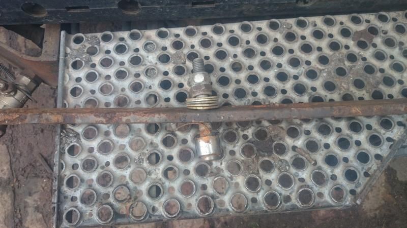

weld a bolt to the inside,another mechanic who i work with came up with the idea

to be honest its the only way if it knackered

Yep old fashioned but tried and tested way of removing bearings from inside a housing. when you weld round the inside the weld shrinks as it cools reducing the outer size of the bearing.
Not seen the size of one of these before but you could use a allenbolt (as there much harder) and grind down the head to try and catch the back of the bearing then put it in and hammer a second bolt down the side of it jam it in there so you can pull it out using a nut and bar like in the pic or a sliding hammer. It's surprising what you can make one out of if you have a wee bit of imagination

They don't look very big by your pic Karl? Could a you get a big rawlbolt into it? Tighten it then drag that out?

they look small but belive me its a mission to get them out once they are knackered, we tryed many options including tapping a big tap to the cavity wall of the bearing but was to tight so,austin came up with welding a bolt in it to extract it, a freind of mine who owns a garge and hes had the same problem and uses the same method as the picture above
