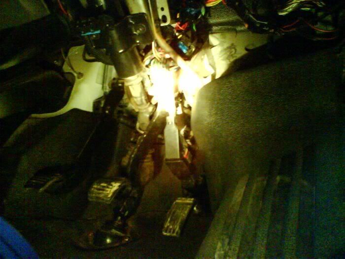

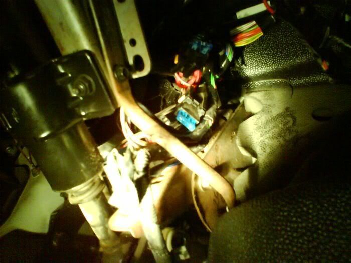

Postby sc_BK » Sun Jul 22, 2007 8:47 pm
Mine are just hanging there
Top of the pic, in the middle. 2x blue (15amp) fuses:
sc_BK
Posts: 6100
CENTRAL LOCKING
Postby stustanley » Sun Jul 22, 2007 8:52 pm
sc_BK wrote:Mine are just hanging there
Thanks a lot. Found these and thought i should be finding more as well. Will check these now!
