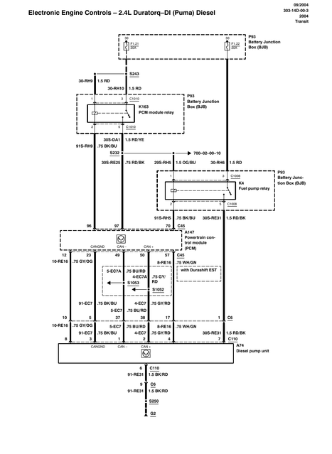

The Mk6 has normal wiring..."NOT" Can-Bus.
Can-Bus wasn't introduced on the Transits until April of 2006 on the Mk7...
Below is the Can-Bus system of the Mk7....none of which is in the Mk6.

Drawing and wiring is fine but it is "NOT" a proper Can-Bus....
And the Mk6 & 7 Transits don't have an ECU as such...they're called a PCM, (Powertrain Control Module).
