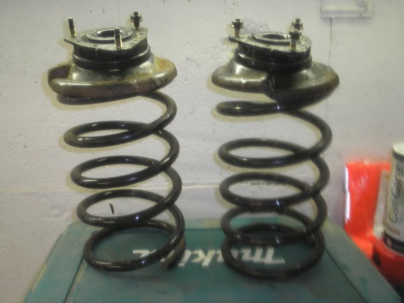

Having had all the bits for a few weeks now i dicided to start the conversion.
Decided to start with the front.

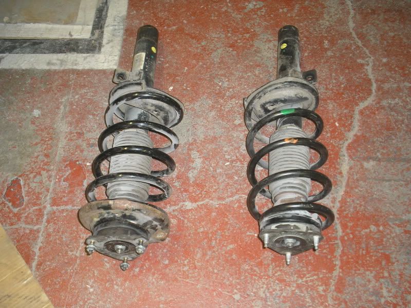

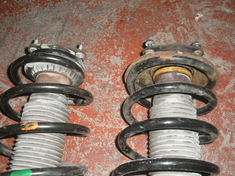

Focus rs springs,cups,bearings and top mounts with standard connect shocks
Modified and standard shock sise by side.

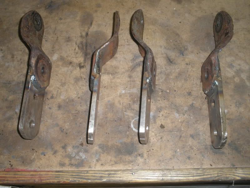

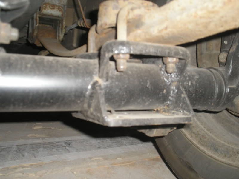

Took the beam off ,made and welded new brackets into place,exactley 180 degrees from the original.

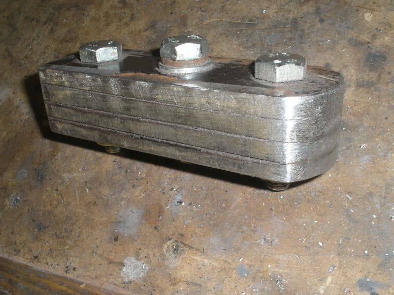

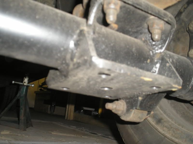

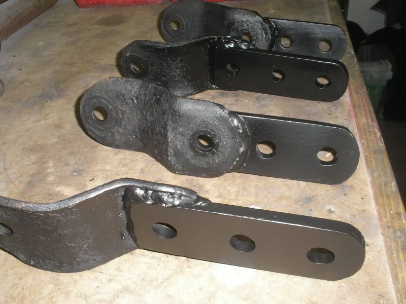

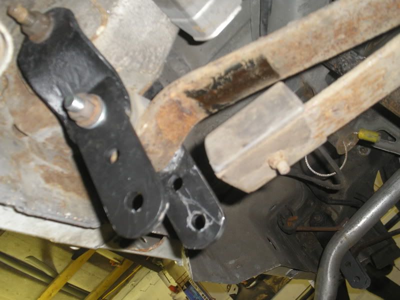

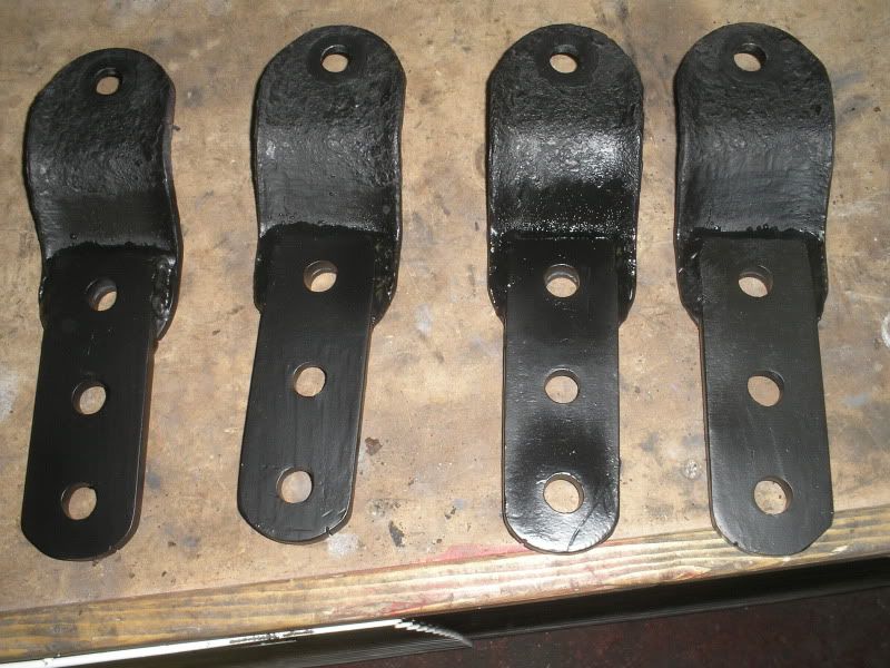

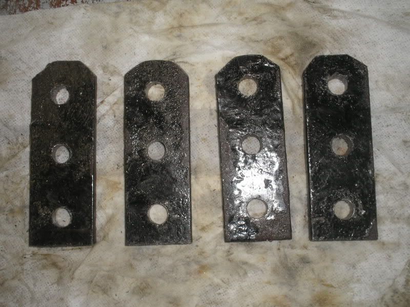

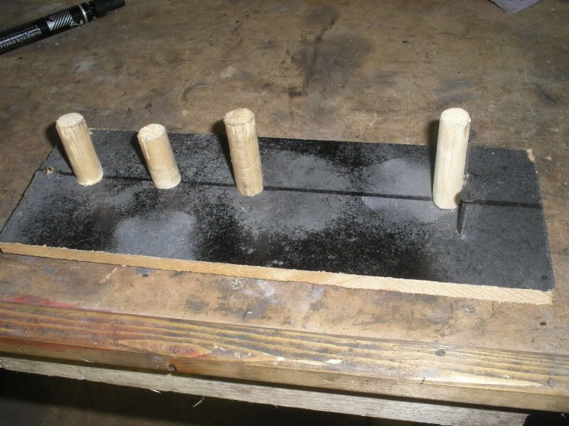

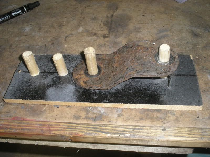

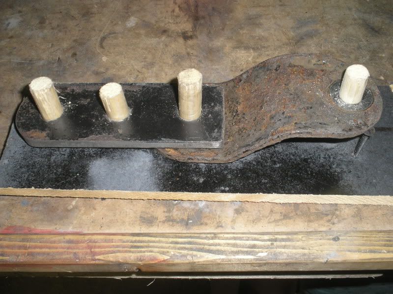

As the rear is a simple axle flip the common problem is that the rear sits too low when this is done,so dicided to mod the rear spring mounts allowing the rear to be adjusted.Made these 4 bracktes,bolted them together and shaped them all the same

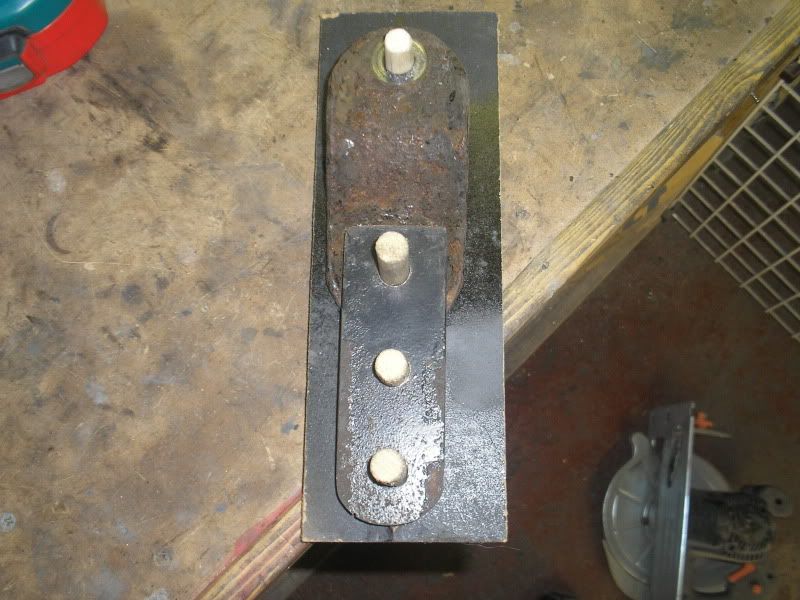

Made a simple jig so they are in the same place when welded to the spring mount
All welded and painted.

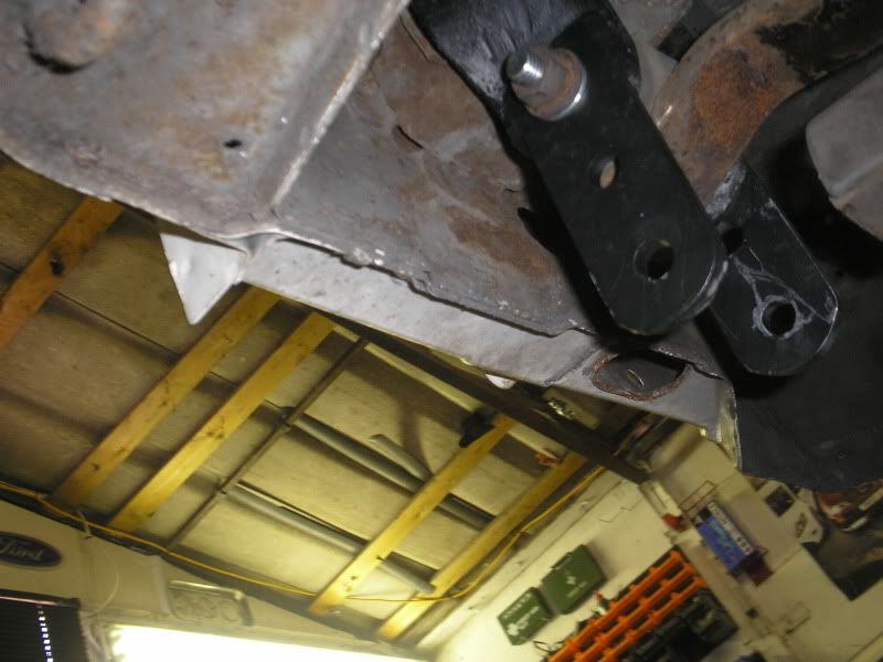

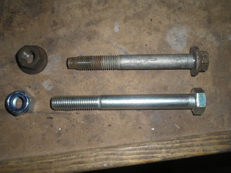

Then fitted,as the bracket was 8mm wider i needed a longer bolt.

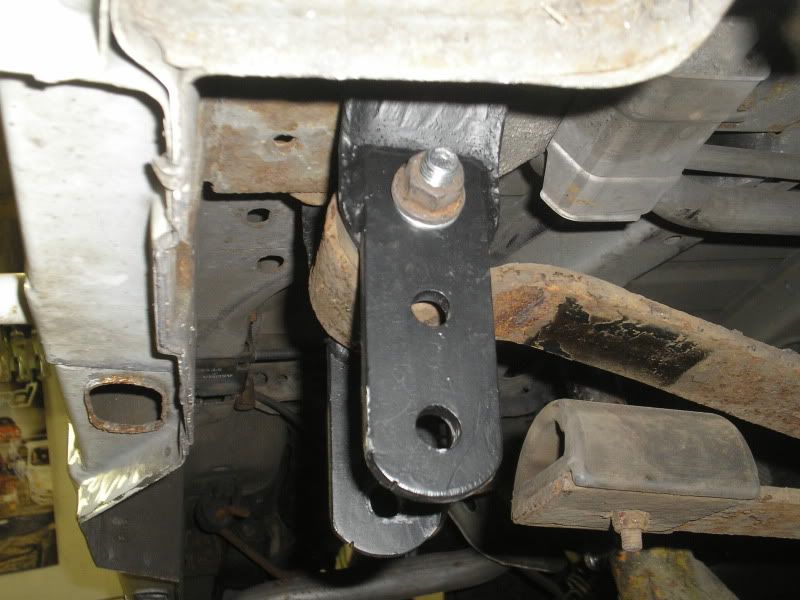

This is the longer bolt i needed.

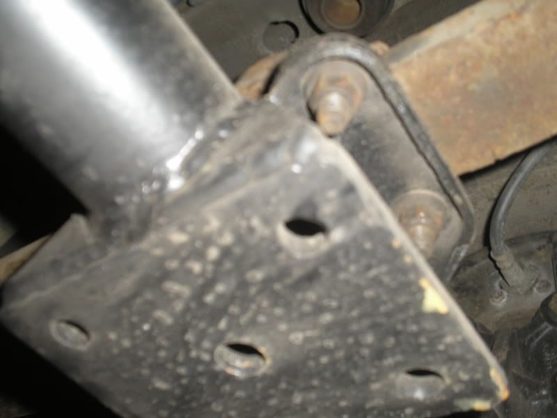

Now all fitted,pic shows the original position but i have used the centre hole,could make the van higher by using the bottom hole if carrying something heavy and only takes 5 minutes..

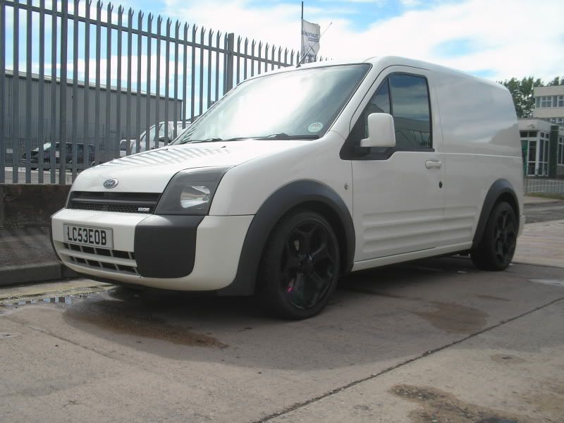

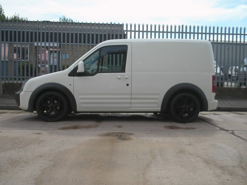

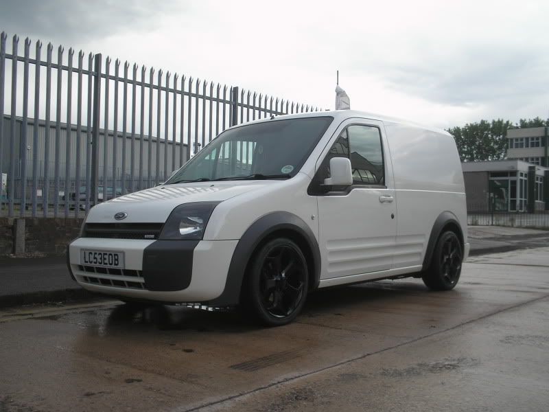

And heres it all finshed.Painted my rims and facelift bumpers so you get the finished article.
Having driven it to Ford fair today it wasn,t as harsh as other cars iv,e lowered.Very happy as all in it,s cost me £80

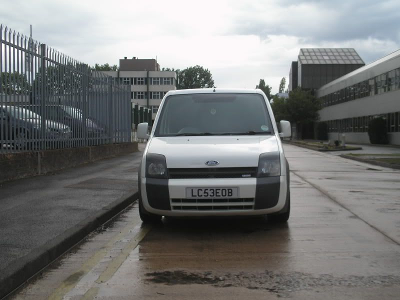

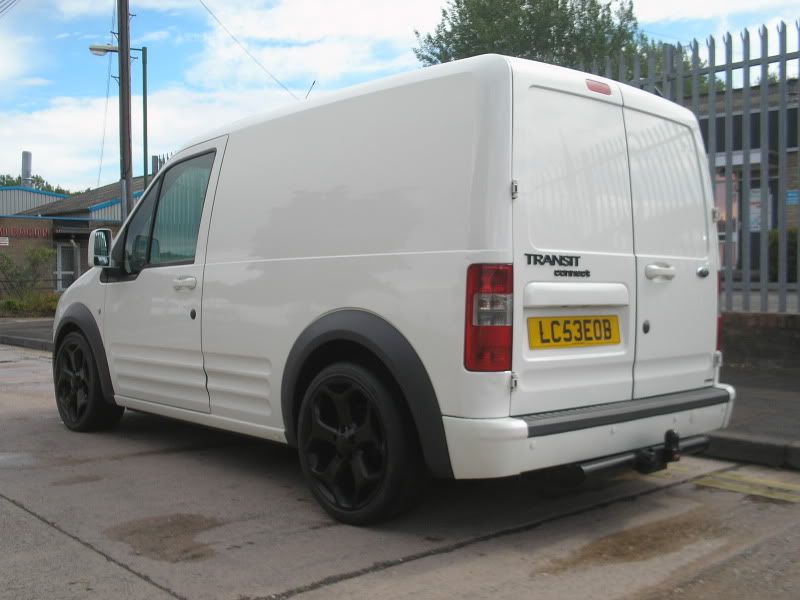

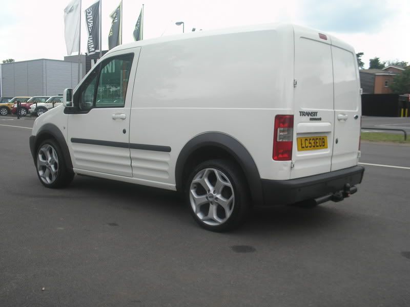

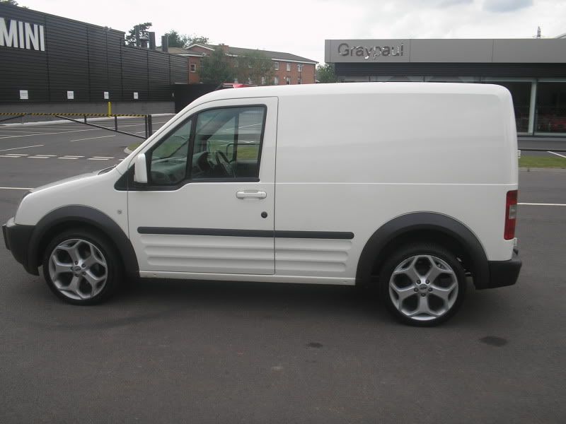

Postby van mann » Sun Aug 07, 2011 11:29 pm
Before and after pics.
Before:
After:

Postby jonny s » Sun Aug 07, 2011 11:34 pm
looks great!
how does it handle now??

Postby van mann » Sun Aug 07, 2011 11:39 pm
jonny s wrote:looks great!
I was quite surprised.Not too bumpy and doesn't bottom out.

Postby Mylee » Mon Aug 08, 2011 11:58 am
How about posting the plate sizes please?
