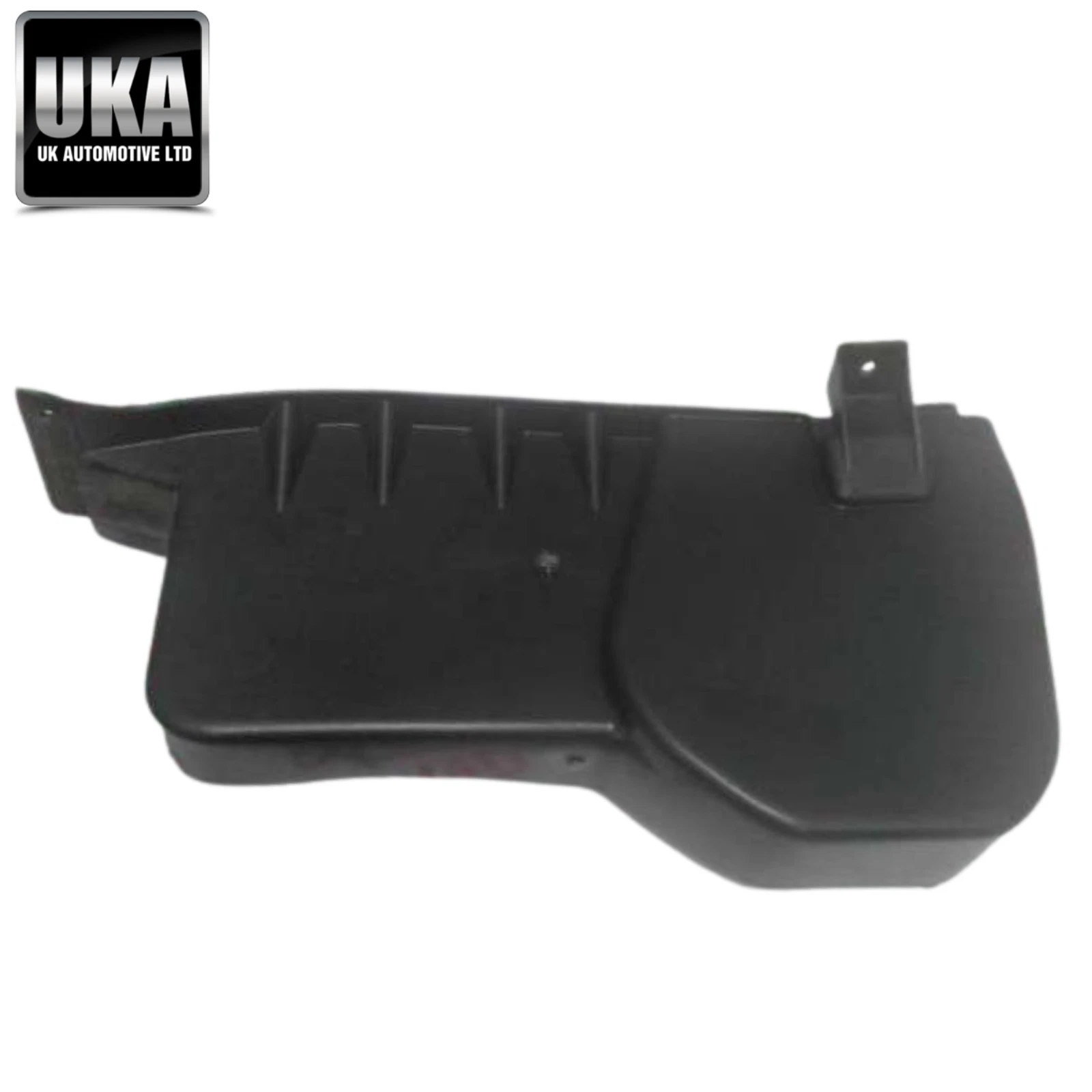

Thanks, that worked. I've jacked her up today on the sub frame like you said, took the wheel and splash guard off. There's metal behind the plastic shield (please see attached photo) is there a way to get through this? I can't seem to find any bolts to remove it. Or is there any way to get to the crankshaft from the top of the engine?

Postby metalworker0 » Sat Nov 08, 2025 6:30 pm
there are a couple of screws that go upwards vertically.
accessed from underneath
top of picture on on a 90 degree plastic bracket thing .. the others at the other end
https://i.ebayimg.com/images/g/J98AAOSw ... l1600.webp
those disks are beyond saving unless you have a lathe
