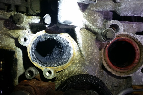

i have a feeling what you are experiencing is normal, if driven at that speed ..in what country ..for all i know you may be in southern spain at temperatures of plus 25c
note: its close to the top speed, so you are really pushing it , you have an old engine ..probably coked / carboned up inlet manifolds, and inlet tracts, as well not helping./
older engines becoming carboned up due to EGR and direct injection is common.
can look like this after high mileage
https://www.fordownersclub.com/uploads/ ... 5e9032.jpg
