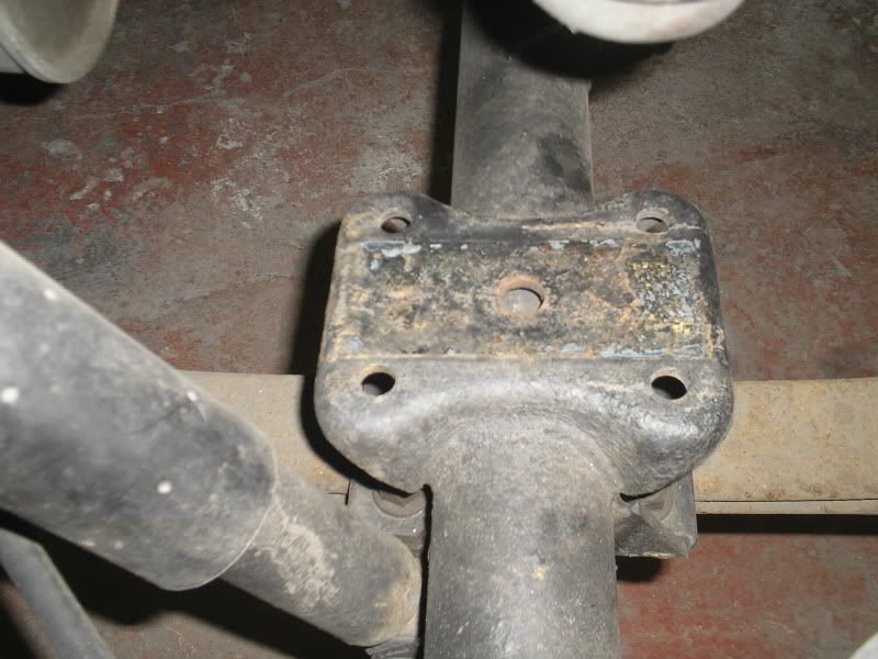

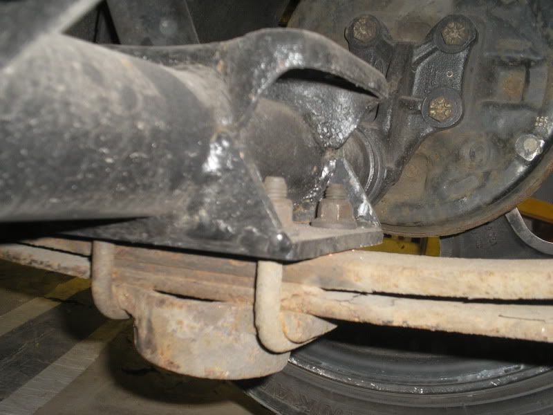

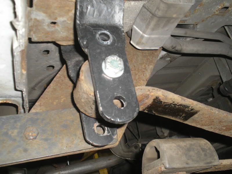

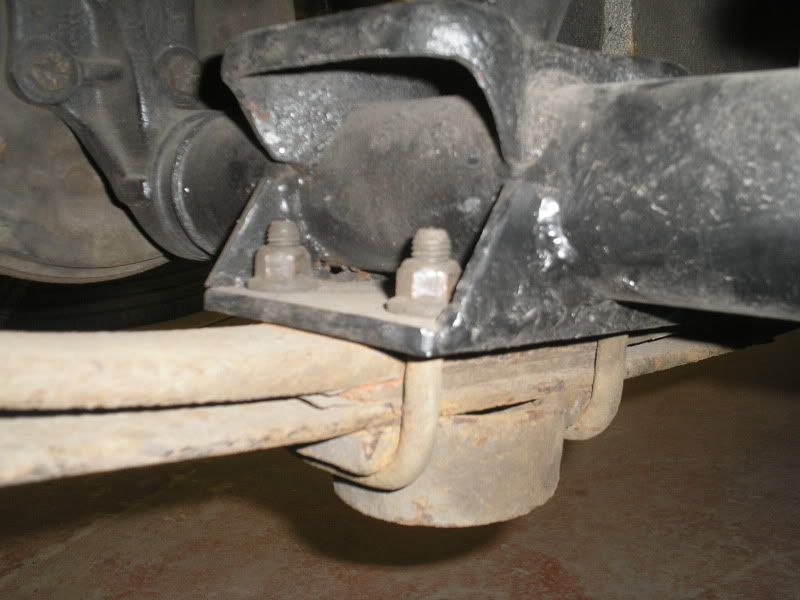

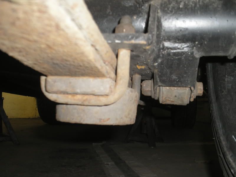

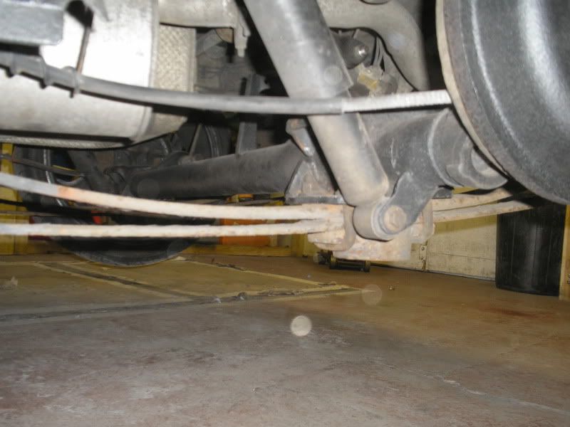

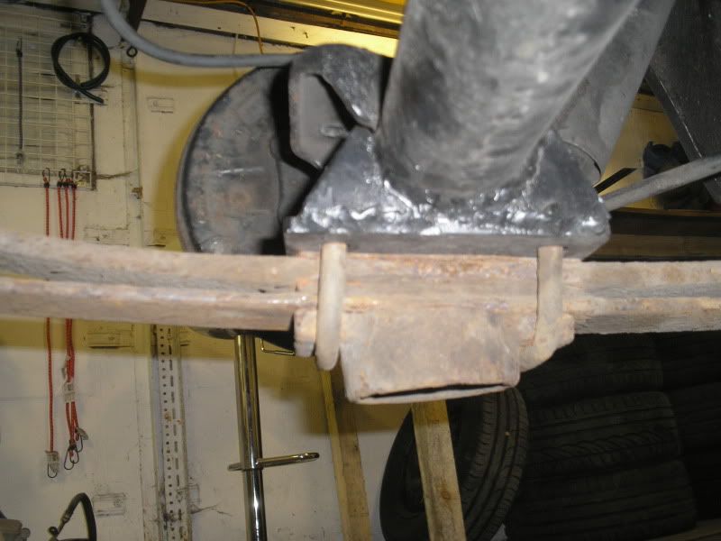

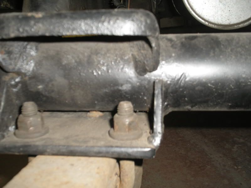

To all the people that have purchased my rear lowering kits here is a few pics and tips on how to fit them.
Tips:
1.In the kit you get 1 normal washer for the extra long bolt and 2 spacer washers.Only use the spacers on the bottom and middle holes of the shackle brackets.(Use your old nut on the new longer bolt.)
2.On the 4 rear shackles i have cut matching notches in each of them.Please make sure they are facing the same way before you weld them.
3.When welding the square plates to the axle make sure it,s directly underneath the original one and also DON,T weld it flat to the axle .Leave a 4mm gap as seen in PIC 10 ,because when you put the leaf springs underneath the bolt holding the leaf springs together sits in the centre hole of the square plate and will bottom out .You can just see it poking through in PIC 1

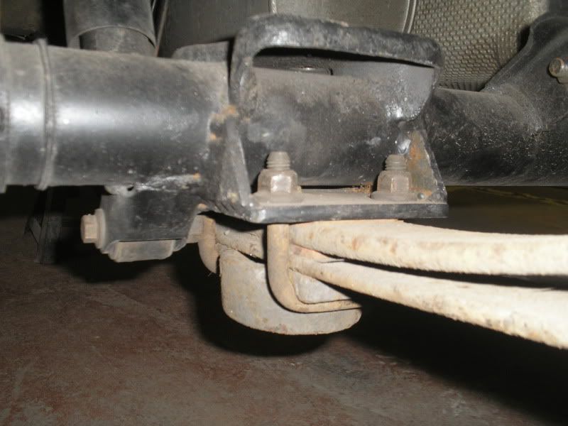

4.After lowering it you need to adjust the brake load compensater to the end PIC 2 as the valve thinks the van is fully loaded and the brakes become quite sharp.If you have ABS Ignore this.

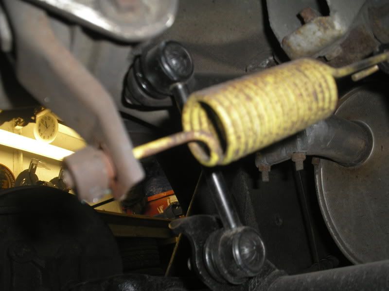

5.You need to cut the end off the bolt going throunh the rear shocks so you can fit the u-bolts.(PIC 6)
6.When welding the rear shackle brackets to the shackles i would reccomend you make a simple jig like i did to make sure they are all welded in excactly the same place.
That,s it .Any problems PM me.
GOODLUCK

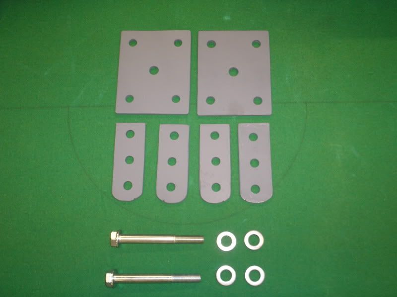

This is the kit that you need.
