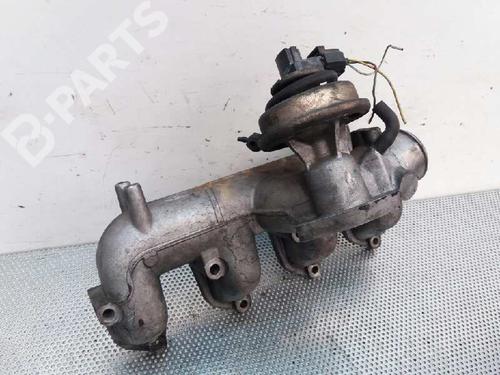

The early ones look like this below - 2002 - 2007 or there abouts. note yours is 2008, not sure, dont think, they had TDDI's after 2007
https://bparts-eu.s3-eu-west-1.amazonaw ... 71287.jpeg
so more likely TDCI ..should have electric wires going to injectors, if so.

if the later stepper powered EGR TDCI and some TDDI'S ..you are dismantling ..cleaning, then, working out that it's still working .. if not, complete replacement
Early TDDI as pic above ..you are looking for used second hand ...or buying a updated one that looks nothing like the one fitted or the later ones, that nothing is written about it? no info at all ! or working out how to fix, it salvage it ..from zero information.
