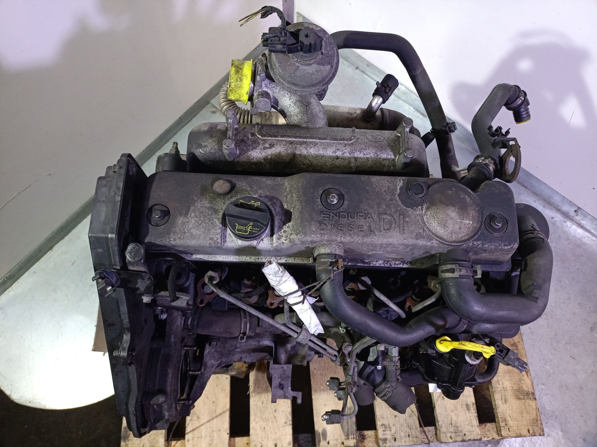

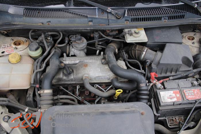

Don't know which EGR valves they had on in this period on yours ..some had modern motorised ones ..some had old fashioned ones ...that no one has ever talked about here ...only talked about swapping the complete unit ..as they say are un- serviceable i suspect yours is such a unit ....i have such on mine ..as that is 2006 and tddi
looks like this ......I've not messed with mine ...but would be sure to tell everyone here, how to go about fixing this unit if it failed. so lost for answer
So cant ad anything ,...as its the "unknown" to me at this point in time
(note to me nothing is un-serviceable, and there is a way around everything, I would take the un- serviceability statement as a challenge)
Anyway old Fashioned one looks like this ...note the thing at the top of the picture that controls it

but not this ...this is the newer type that is FULLY serviceable
https://cdn.proxyparts.com/parts/100109 ... 96603f.jpg
And its worth checking the vacuum pipes and wiring ..that's where i would start
note vacuum pipes are also linked to turbo actuator ..i think ...so loss of vacuum could effect that also ..so you'd be well down on power!

Mine is the old EGR one (first 2 pics you sent me)
No idea how easy they are to swap out, but I’ll check the vac pipes for leaks. If not then I’ll get a new unit, but I think the main concern is the temp needle sitting at max as it’s shutting engine off after 5 mins with fan on. So I think I’ll try new temp sensor first and go from there.
