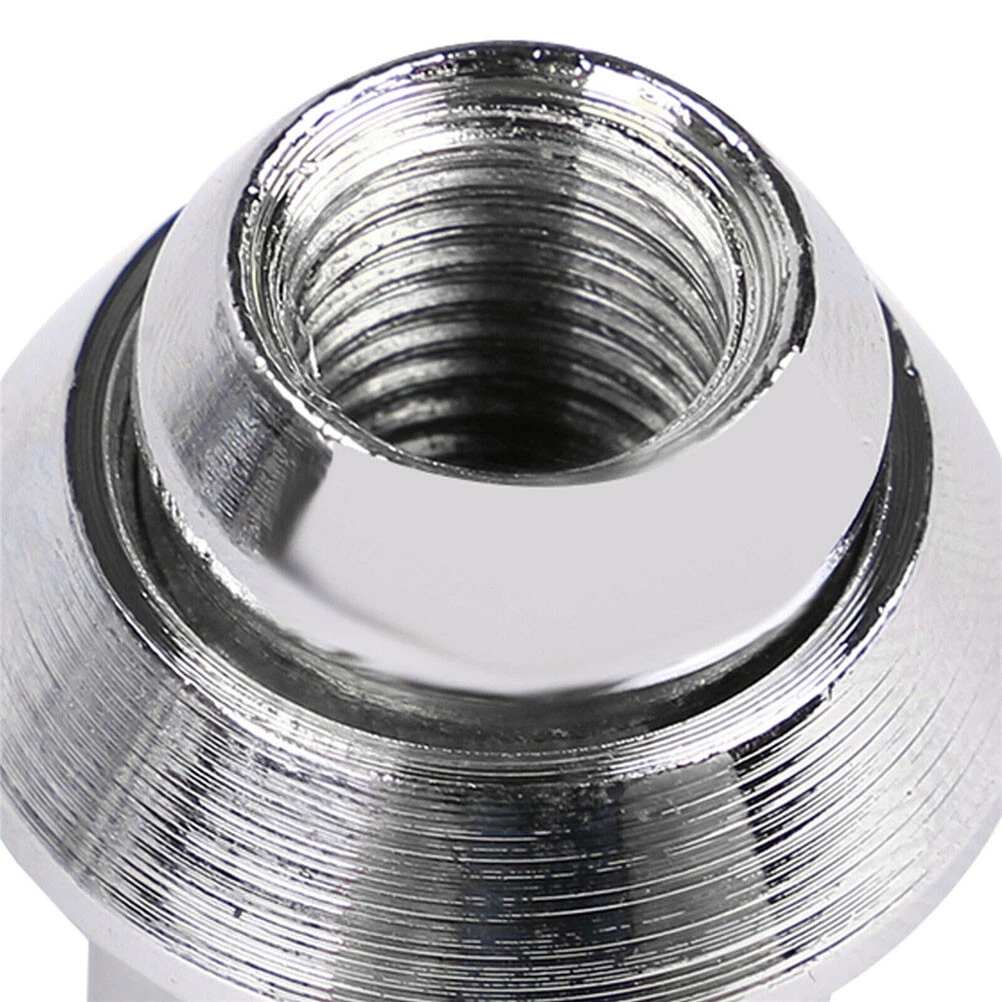

i bought wheel nuts that have thread going all the way to the end as fords dont ..
note though - these ebay ones i bought went rusty within twelve months finish on them isnt chrome, its polished nickel plating
ebay ones
https://www.ebay.co.uk/itm/303718599811 ... 18&mkevt=1
close up of threads ... you can get about maybe 6 threads on my ford alloy focus wheel with original studs using these nuts
https://i.ebayimg.com/images/g/SToAAOSw ... l1600.webp
close up of gen ford threads
https://i.ebayimg.com/images/g/CIUAAeSw ... -l960.webp
You will get maybe 3 threads with the ford ones... last owner numbskull... thats what he did ... some of them came loose on their own
Other than that you are destroying and replacing wheel bearings .. good luck
