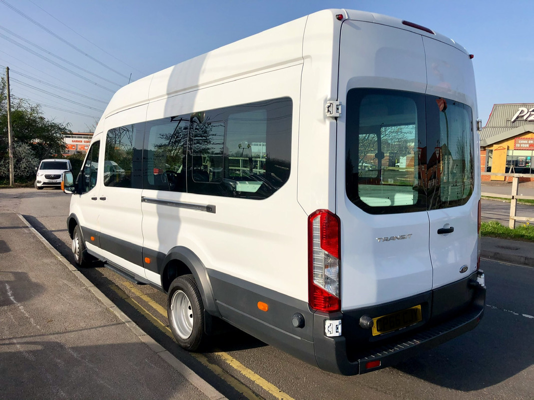

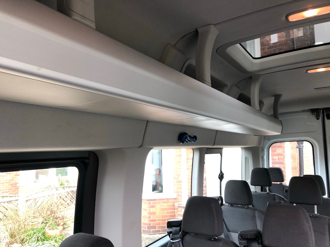

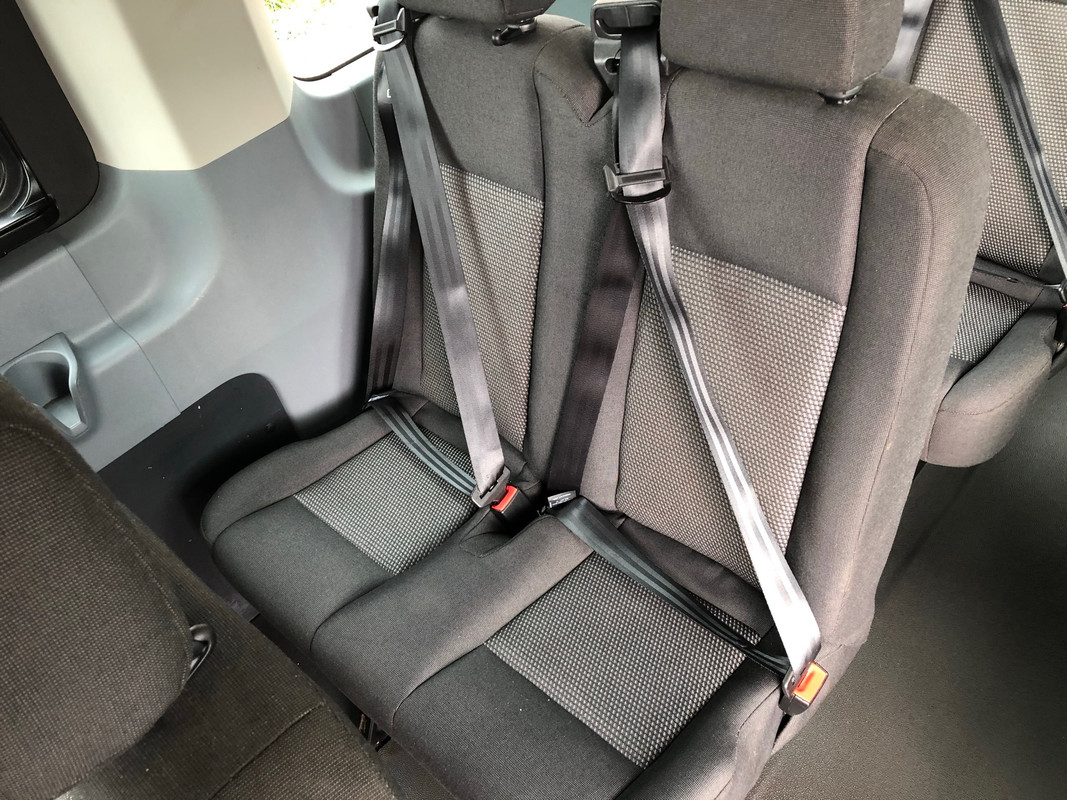

Postby Rob62 » Sat Apr 03, 2021 11:50 pm
First photo’s of the project, progress so far; strip out the rear seats and trim, wash down the interior which wasn’t bad at all, now fitted the passenger swivel seat. Photo’s are before the wash down. More to follow.

Postby workbox » Sun Apr 04, 2021 12:38 am
Nice project, love to see your progress forward.
I have similar campervan build out of commercial mk8.
I am sure you are aware of side plastic trims tend to water leak, worth to mention.

Postby straydog » Sun Apr 04, 2021 8:17 am
Good looking van. going to be an interesting project to follow 8)

Postby Boltrounder » Sun Apr 04, 2021 8:42 am
Nice van are you going to put a wet room in ? I’ve noticed that quirky rustic campers are really popular atm and selling well
