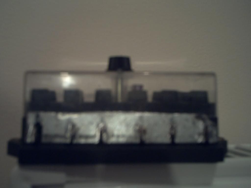

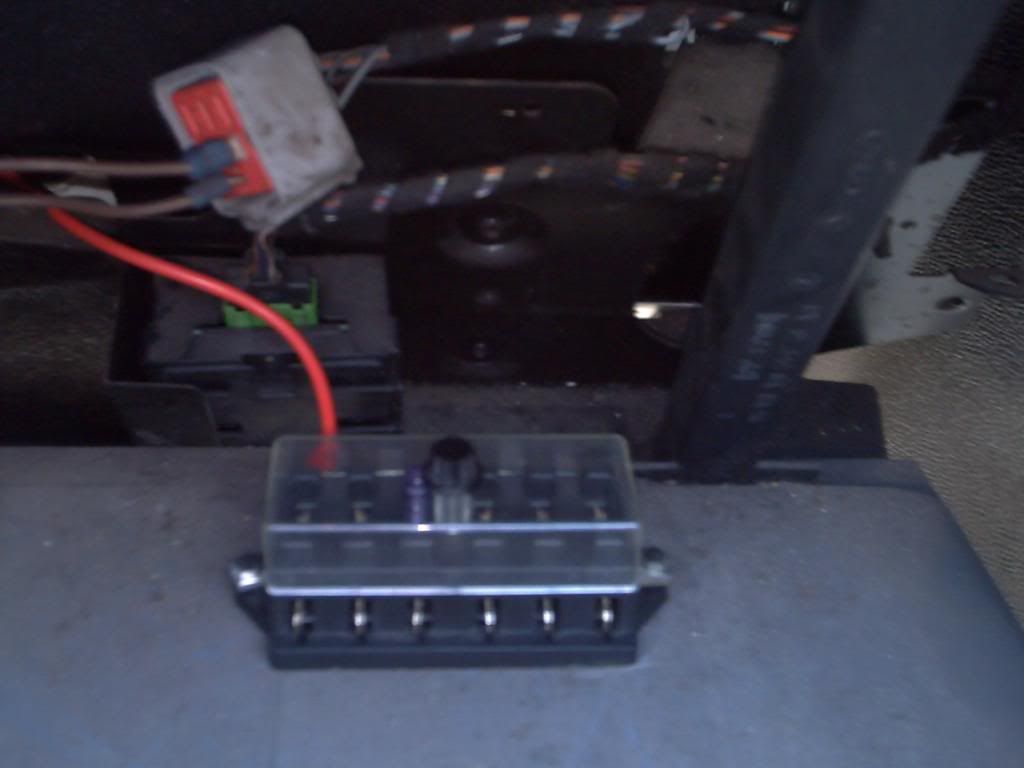

I bought a cheap fusebox off flea bay...cost me 50p! I made a home made bus bar and fixed the box in the space above the glove box (in the dash).
Bus bar
Box in place
From the fuse box we have a 12v heater, LED lights and a 12V socket.

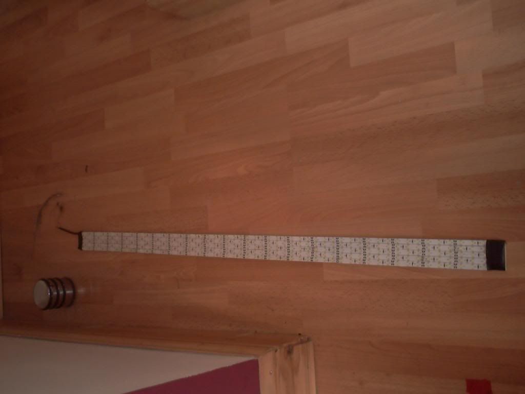

I got another reel of LEDs from ebay..the same ones that I used for the back light strip.
Got a piece of laminate that was just the right length to fit across the cab and it wasn't too wide so no need to saw it...result!
So, I cut the LEDs into strips and stuck them to the laminate and then soldered them together...without burning myself!!!!
Finished it off with some insulation tape to make it look neater and secure the wires and strips.
Tested them... they work.. YAY!
Then fitted them onto the shelving unit in the cab...
Not tested them in the dark yet...will do that tonight so keep an eye out for an update later!
