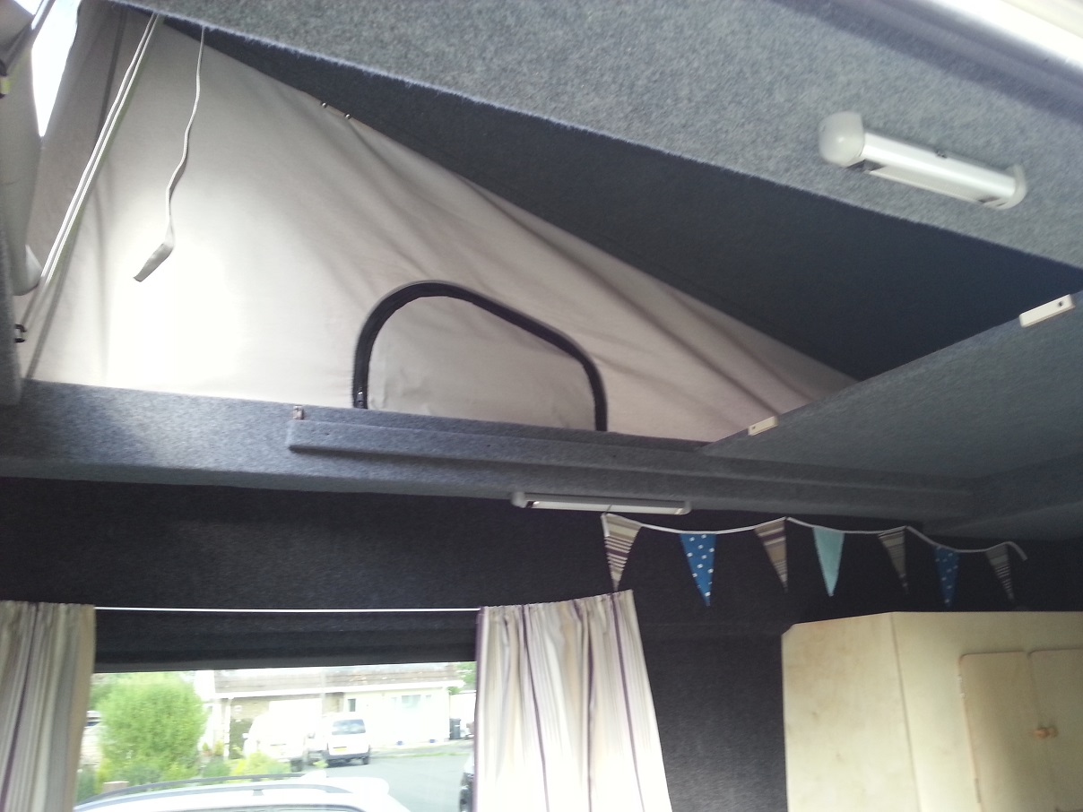

Inside Camper with roof closed
Inside Camper with roof open
Roof Open with Bed
Inside Poptop

As you can see there is plenty of storage space... that is a bonus on a big transit. We hope to add some future development adding extra storage abov window, and low lighting. Perhaps Laminate the cupboard doors. Add a TV arm. Decorare side panel. Bunting, Curtains and Cushions all made by my wife! In total our conversion cost £9000. £3k for the van (56 reg 93k miles), £2k for the roof & install and £4 for interior conversion & windows. Would love to see your comments!
