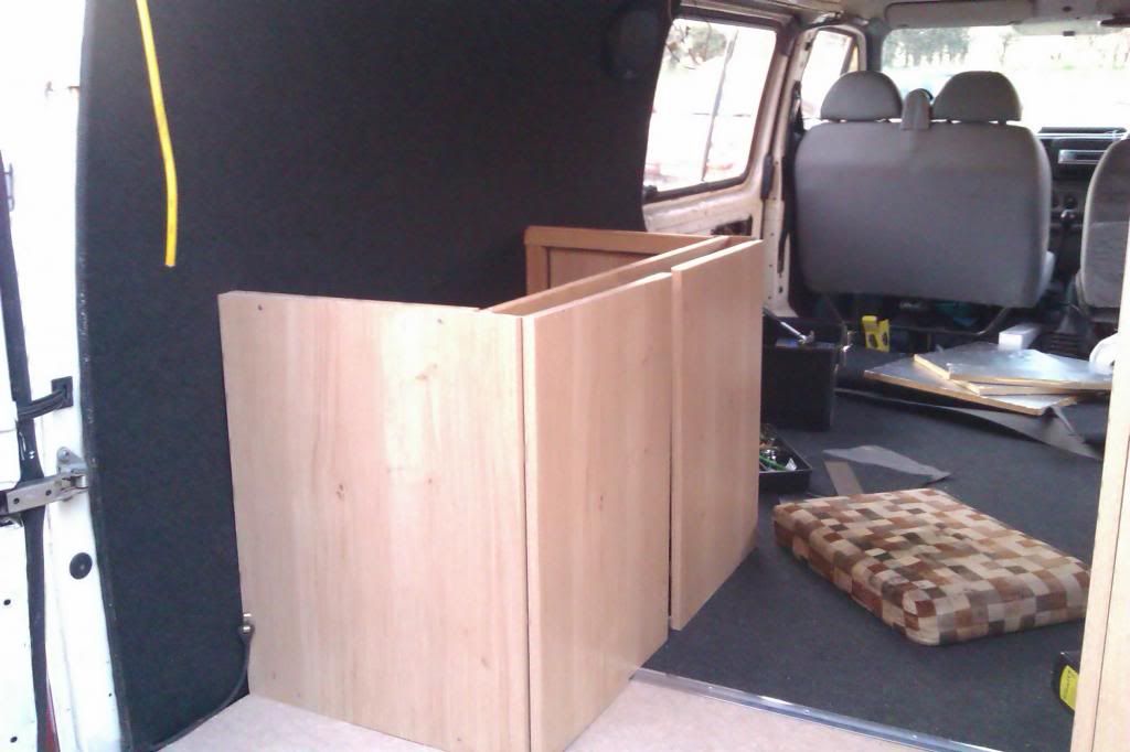

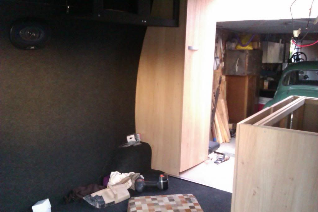

How are you attaching the wood to the sides of the van?

Postby suffolkboi » Tue Apr 02, 2013 10:23 pm
For the wardrobe? Its just L shaped brackets. Like thishttp://www.ebay.co.uk/itm/4x-L-shape-br ... 3cd069eb9c

Postby screechowl » Wed Apr 03, 2013 3:18 pm
suffolkboi wrote:For the wardrobe? Its just L shaped brackets. Like thishttp://www.ebay.co.uk/itm/4x-L-shape-br ... 3cd069eb9c
Right. But are the brackets screwed into just the ply or the metal too? Just thinking it's difficult to see what metal you're driling into once the ply is on, but is it adequate just to fix to the ply? I fixed my stuff into just the ply as the insulation was already done. It's a different ball game with this one; have to do it all myself on that day sooo far away after the weldings been done :roll:

Postby suffolkboi » Wed Apr 03, 2013 8:36 pm
Only into the ply! So long as your ply is securely fixed, pretty much all your fixings can be screwed into it. I just used 1/2 inch screws, and a few brackets at the top and bottom, and one in the middle.
Its still standing!

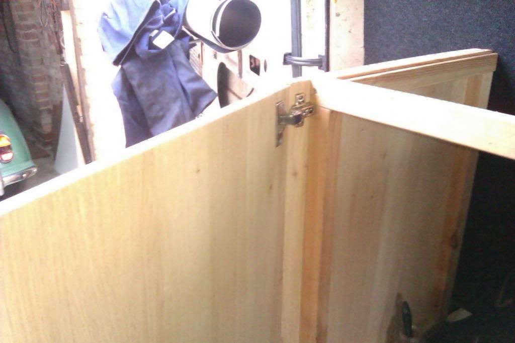

Today i finished off the kitchen unit. I managed to do this and the wardrobe all from one £20 wardrobe. Including hinges etc. So quite pleased with that.
I nearly cocked up the hinges though, as i forgot they need a 50mm offset from the unit itself. Thankfully though, i had enough wardrobe left over to butcher.

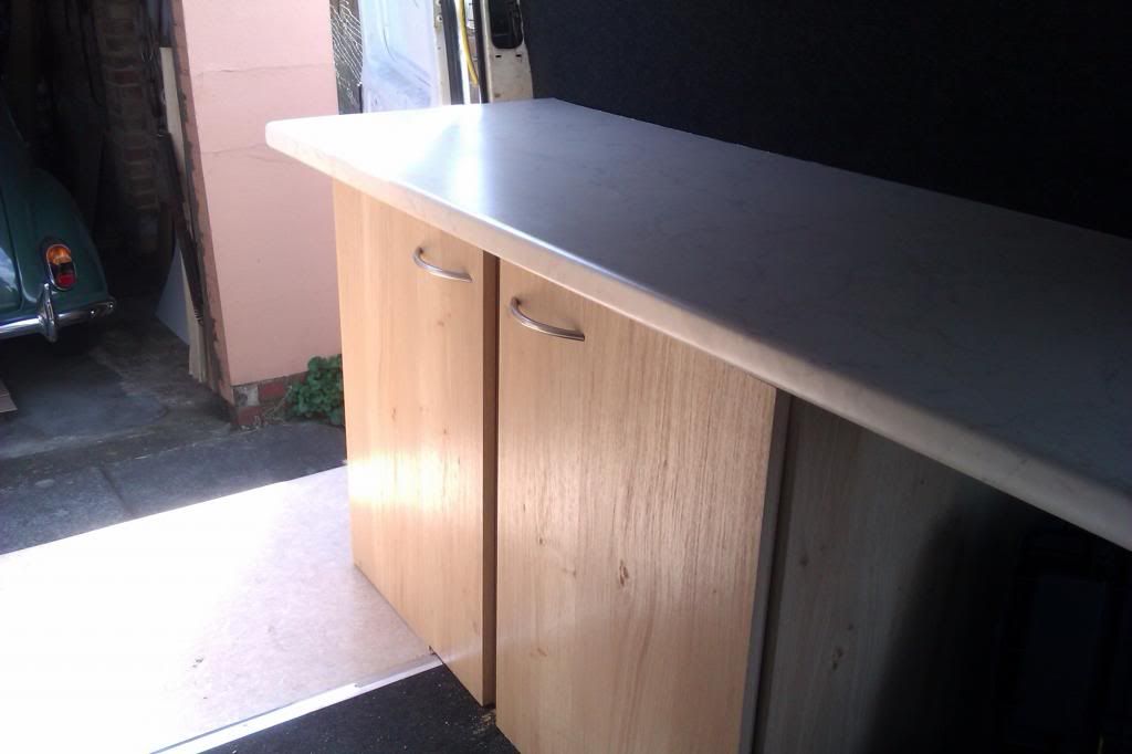

Postby suffolkboi » Thu Apr 18, 2013 8:36 pm

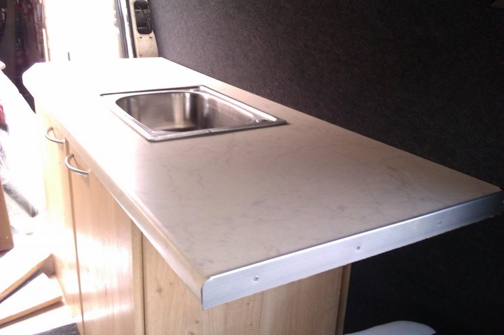

Very small update - fitted some handles from ebay and 6kg magnets to the doors. Worktop cut to size.
Can't decide on round corners or angles.. Iron on vs Metal trim.. Thinking i will bend some metal trim to fit.. Any opinions?

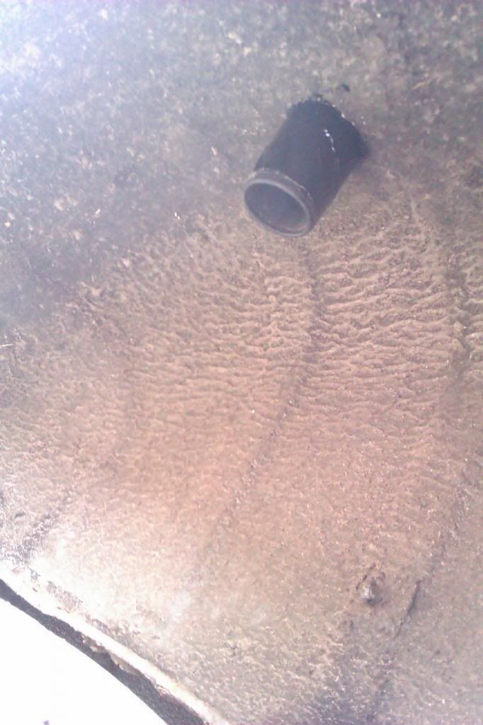

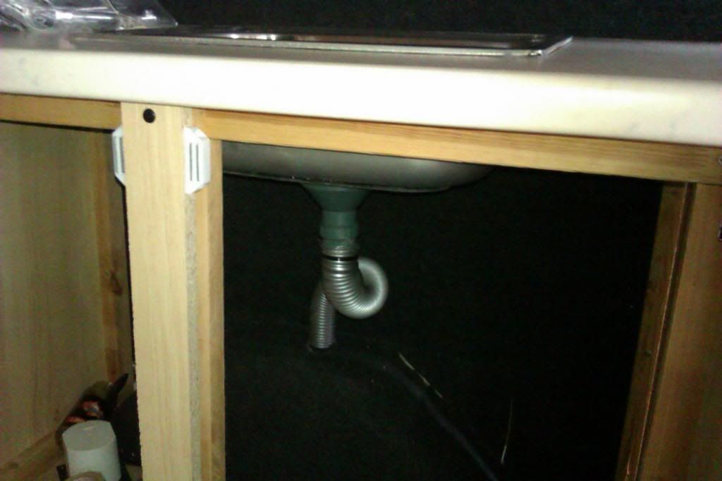

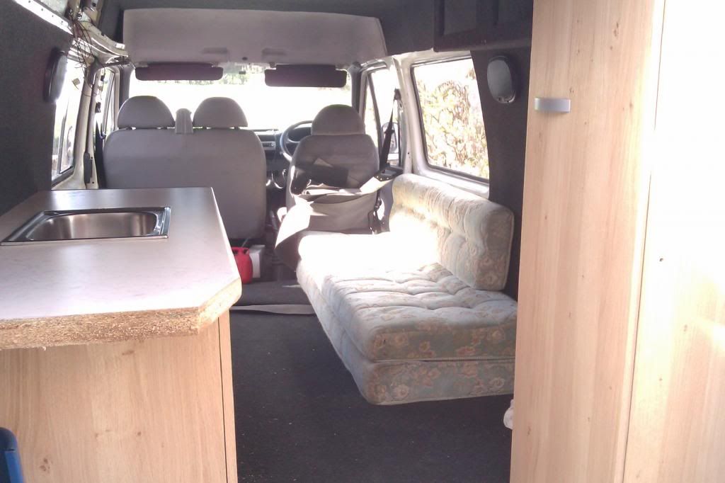

Postby suffolkboi » Sun Apr 28, 2013 8:19 pm
Fitted the sink, and sorted the waste drain. I will fitting another pipe to take the water away from the wheel.
I got hold of these caravan cushions for £25, which i think was a bit of a bargain. These will covered.

Postby darkbluevanman » Sun Apr 28, 2013 9:48 pm
Love it, one wheel washed almost everytime you use it.... but worry that eventually the tyre could smell of wee :wink:

Postby suffolkboi » Sun Apr 28, 2013 10:15 pm
I like your thinking... but im not keen on a smelly wheel, so i will attach a pipe.

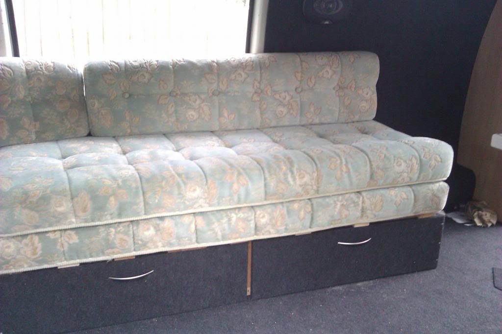

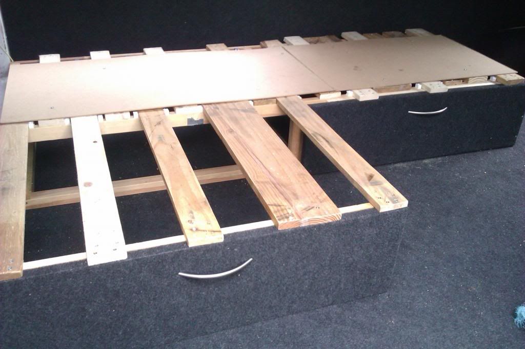

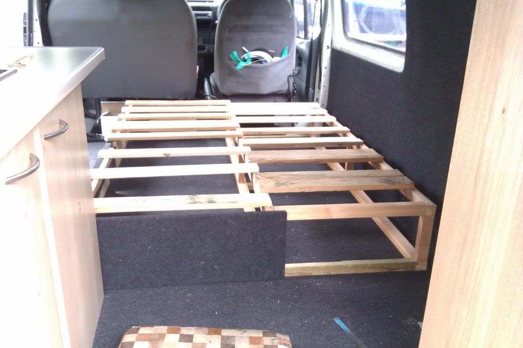

Postby suffolkboi » Sun Jun 09, 2013 6:38 pm
Been working on the bed this weekend.

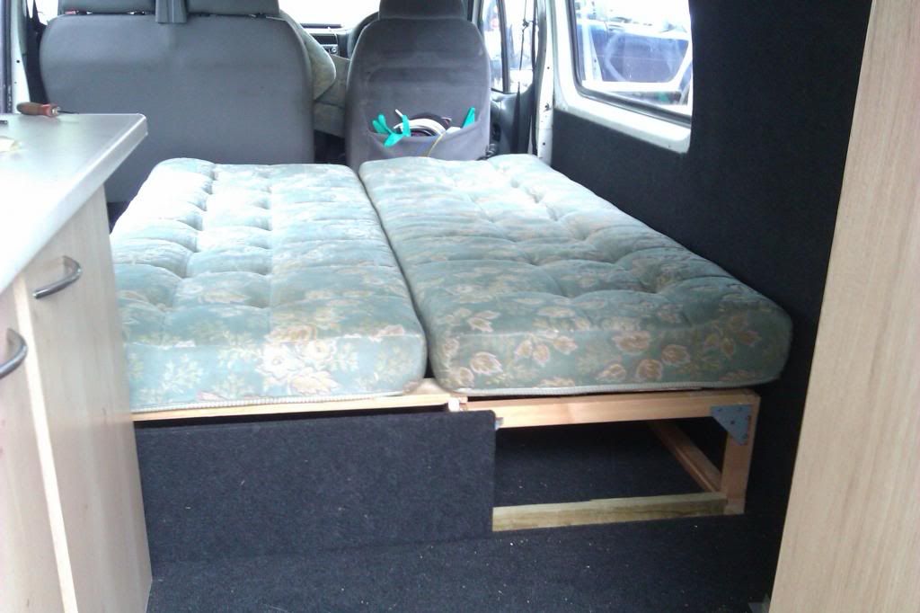

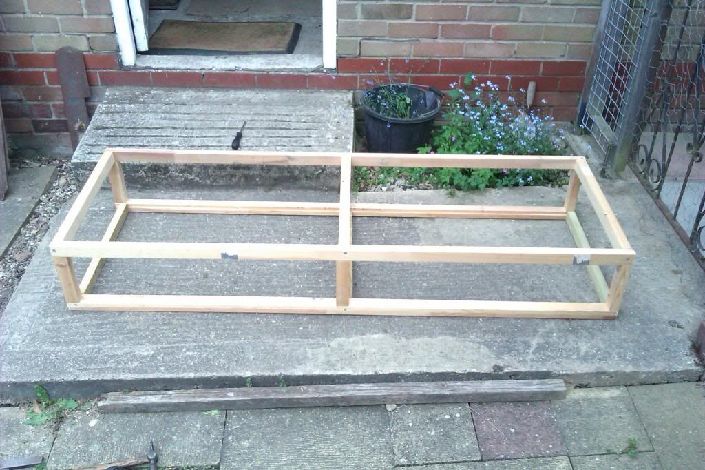

Postby suffolkboi » Sun Jun 09, 2013 6:39 pm
