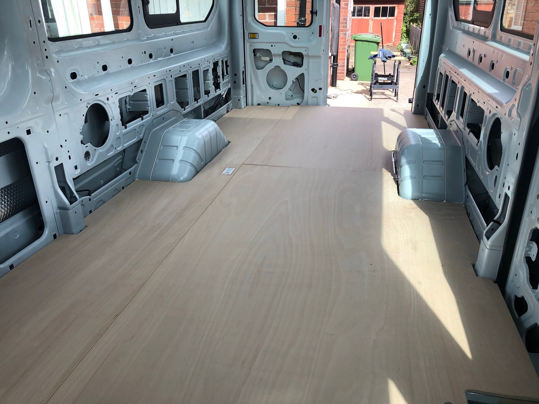

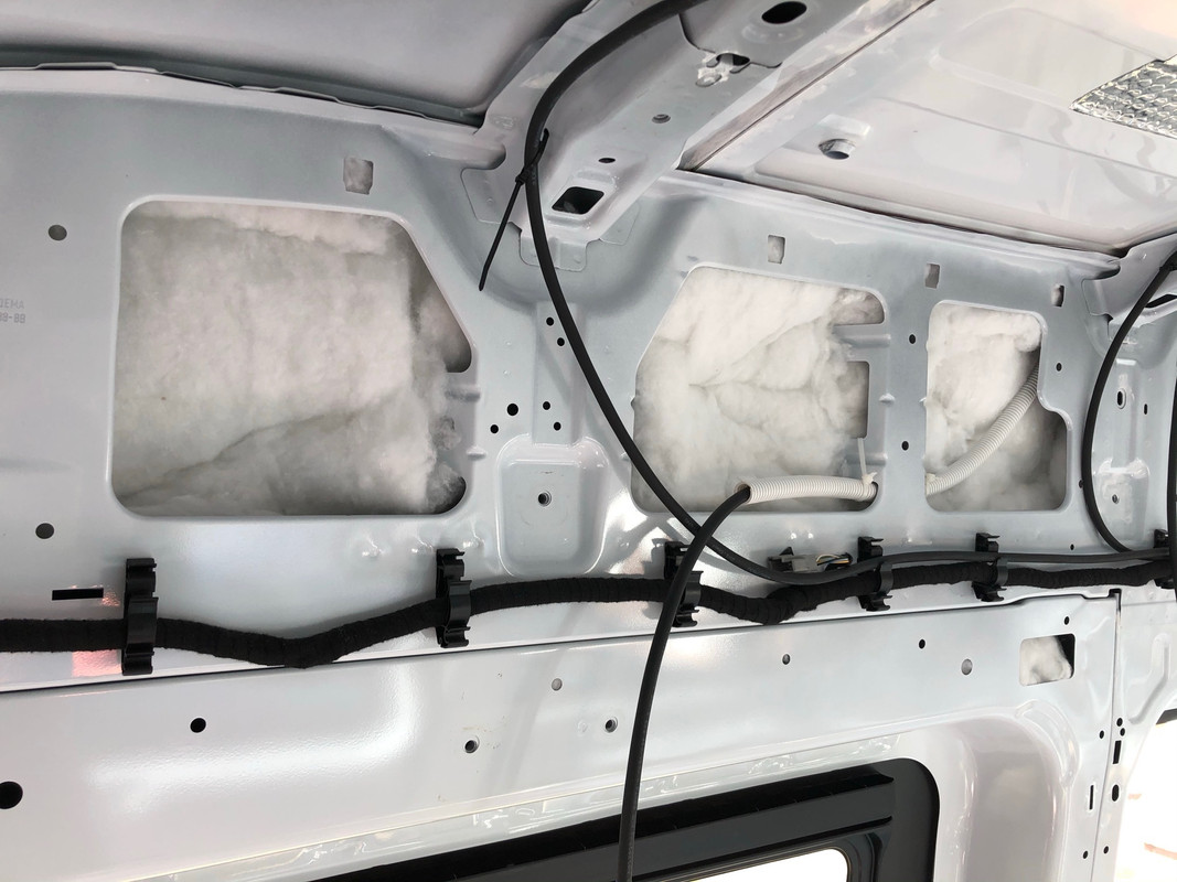

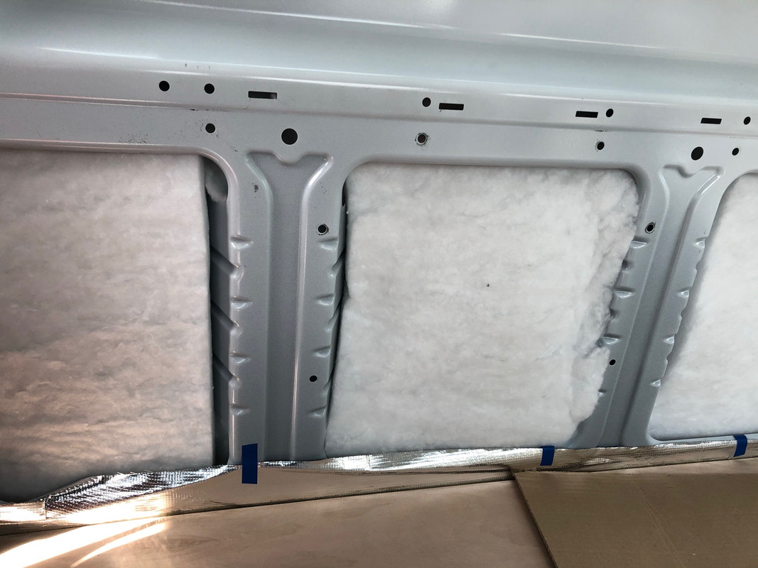

Bit of an update.. progress been a little bit slow recently, all this crap weather doesn’t help.. After fitting the seats and running a bit of trunking and cable i started on the floor

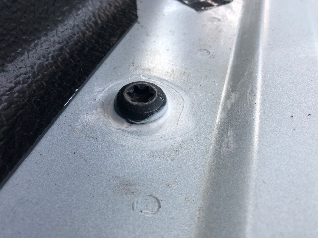

Ive seen various methods of filling the holes in the floor left after removing the seat rails, from tape to gluing 5pence pieces...what better way than using the screws, just put a bit of copper grease on to prevent corrosion and a bit of mastic.

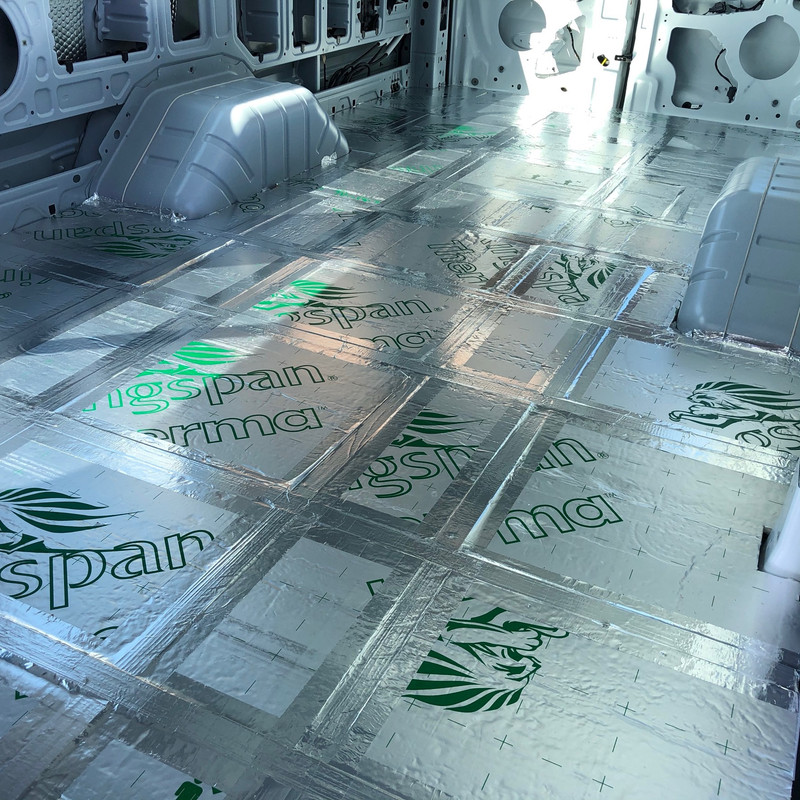

Then I fitted some battens down with sika522, filled in the gaps with kingspan and taped over with 100mm aluminium tape.
Next job was to cut some 12mm ply .. all the joints will be either in the garage or under the bench so I didn’t bother to biscuit joint them. They were pretty good even so.

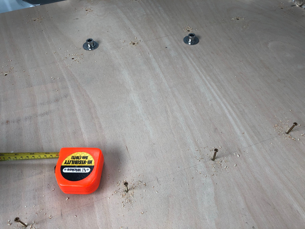

I drilled holes to enable me to bolt down some luggage loops to the chassis for securing the motorbikes. They will also help prevent the floor from lifting in case of an accident... The floor is then screwed down into the battens but not through into the steel base.

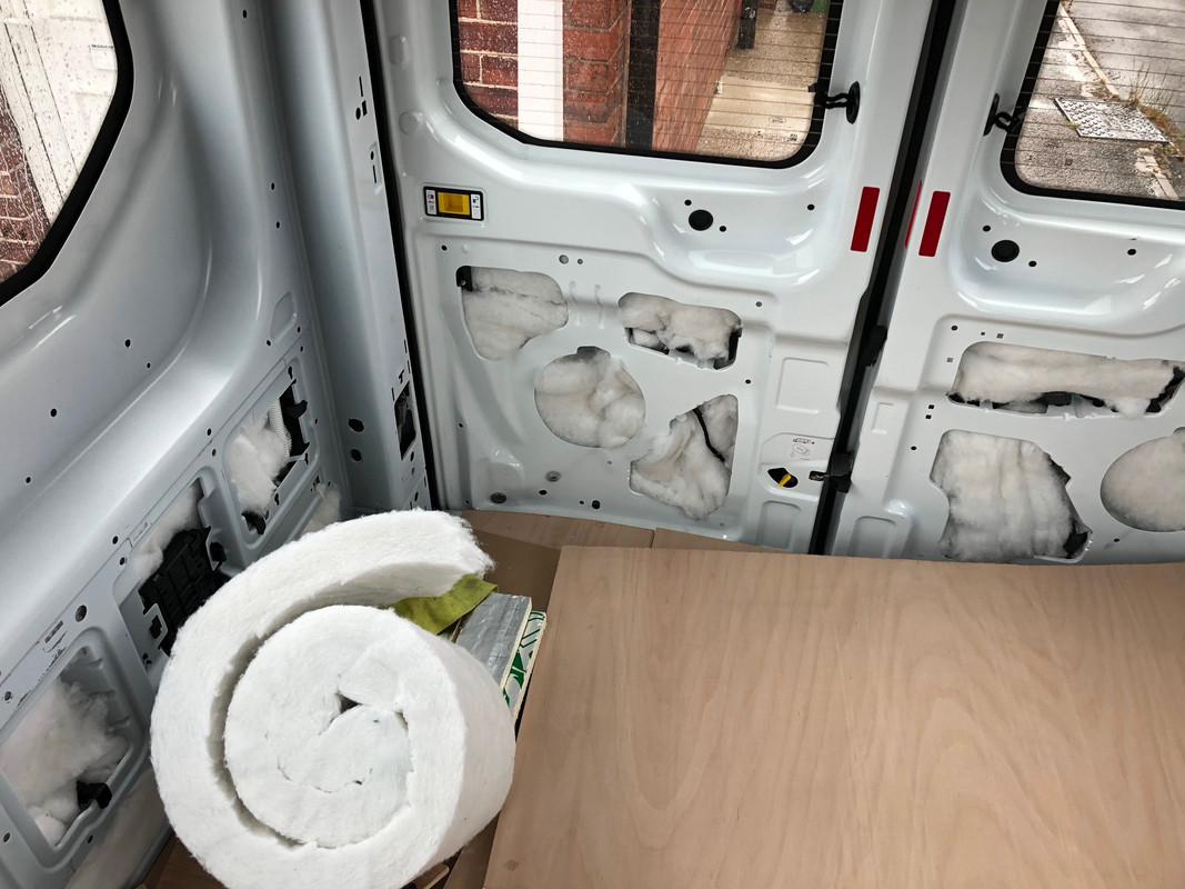

Then I set about insulating the sides with dial recycled plastic bottle stuff... its easy to use but doesn’t go far, 6 rolls up to press, imagine if it was a panel van with no windows..!
Then I’ve been fitting some moisture barrier...
I’ve been collecting stuff in the background, some anthracite carpet, a maxxair delux etc but need a bit of dry weather before I fit that... Looking forward to finishing the insulation and panels and getting on with the furniture....

Where did you get that recycled insulation?
B & Q????
Cheers James
JamesHow
Posts: 111
Joined: Mon May 10, 2021 6:52 pm
Re: 460 minibus camper conversion
Postby Rob62 » Sat May 22, 2021 10:46 pm
Hi james, yes B&Q, £16 a roll... easy to use though and no irritation. Nice kitchen unit btw, i looked at your pictures :-)
