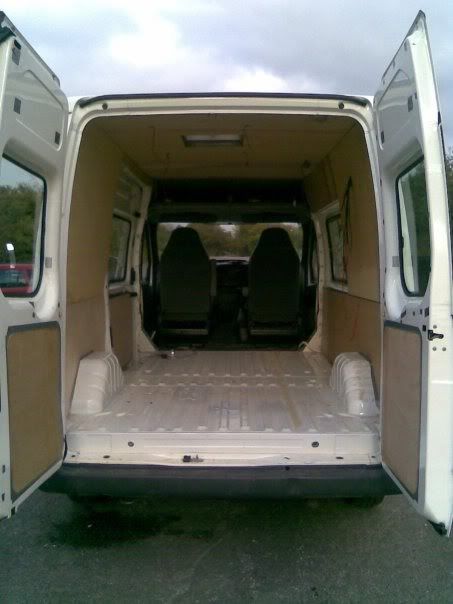

Although we are almost at the end of our conversion (we started in August 09) I thought I would still share some pictures of what we've been up to!
Need some advice on curtains round the front windows if anyone has any!
The Van

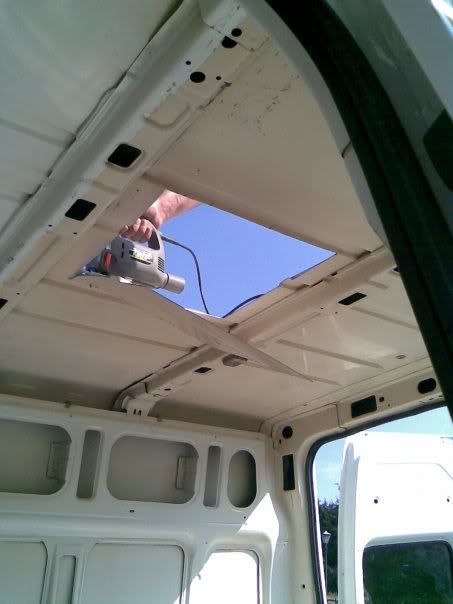

Cutting the hole in the roof - scarey!

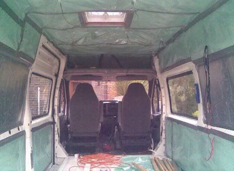

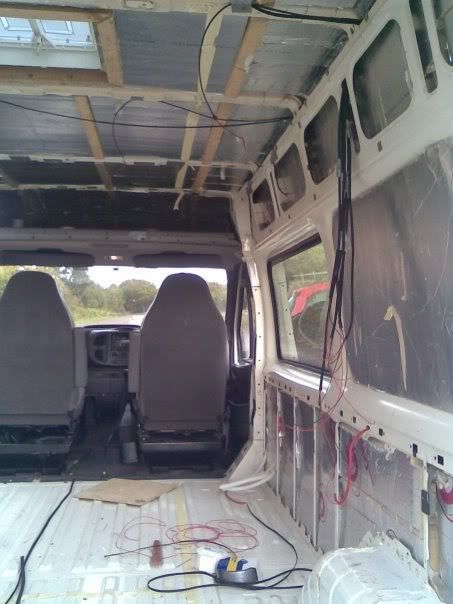

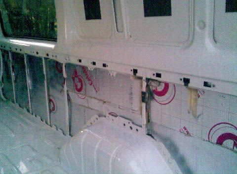

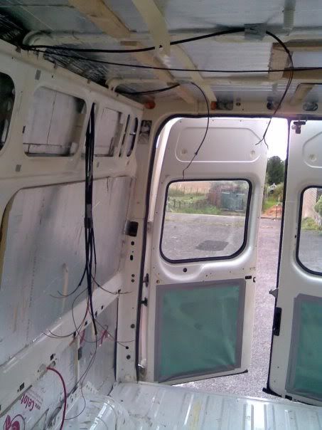

The insulation - perhaps what we found hardest/most boring!!
Insulation and wiring shot!
We had changed the double seat to a single in the front at this point
Damp proofing the insulation (also fun!)

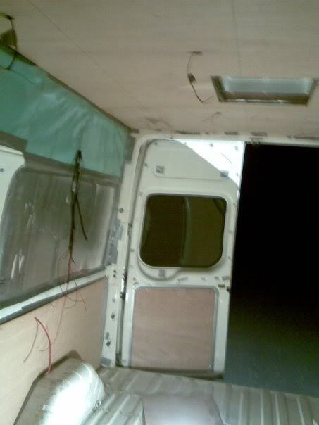

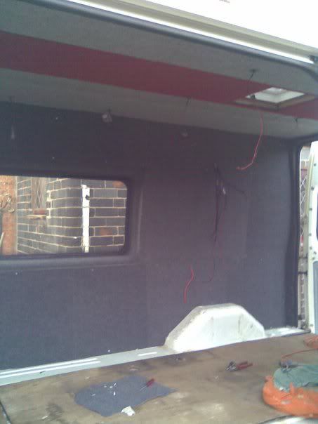

Ply lining
One ply lined van!

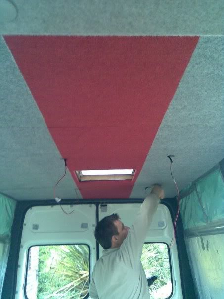

Carpeting panels going in

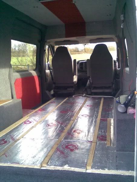

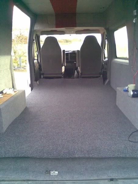

Floor insulation
Floor carpet down

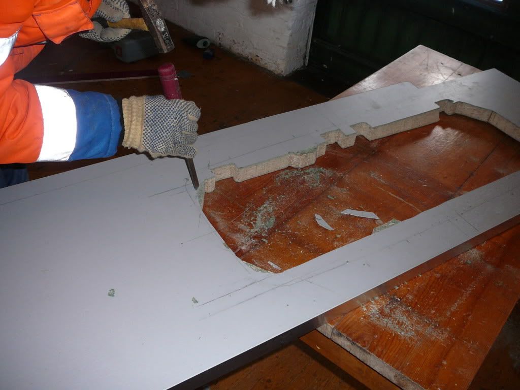

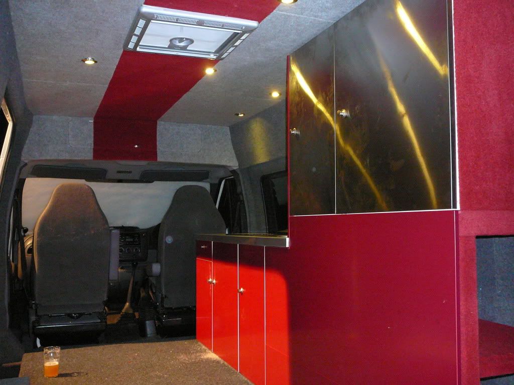

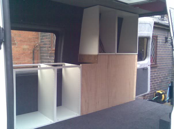

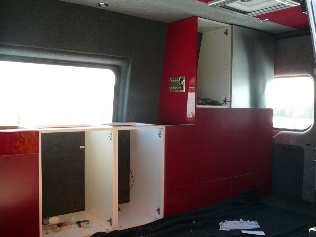

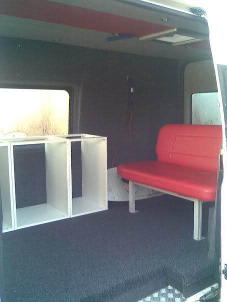

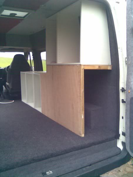

Furniture construction (thanks ikea!)
Box at the rear for kite surfing equipment storage
Attaching the cupboard doors

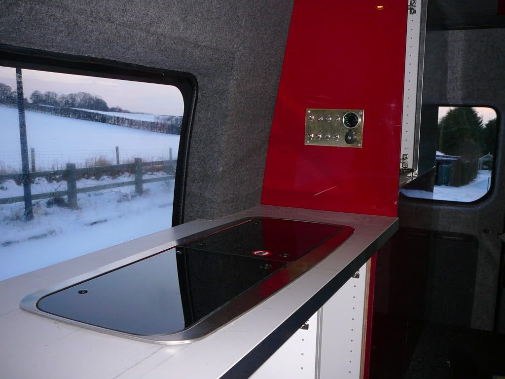

Cutting the whole for the smev

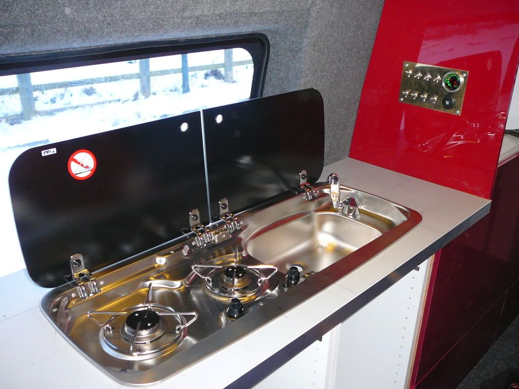

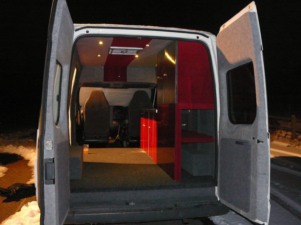

The smev hob and sink is in!
Where we are now

We got our carpet from here: http://www.megavanmats.com/
We found them fairly priced and helpful - they have no minimum order amount which was great for us as we didn't need meters and meters of red carpet! Our local camper conversion place could only supply whole rolls of 10 rolling meters which was A LOT more than we needed and double the price of this guy. He also supplies all the right glue (which is heat resistant up to 70 degrees which may seem excessive but you don't want your carpet falling off in the summer!). They had no red listed in their shop but he sourced some and now seems to still be selling it.

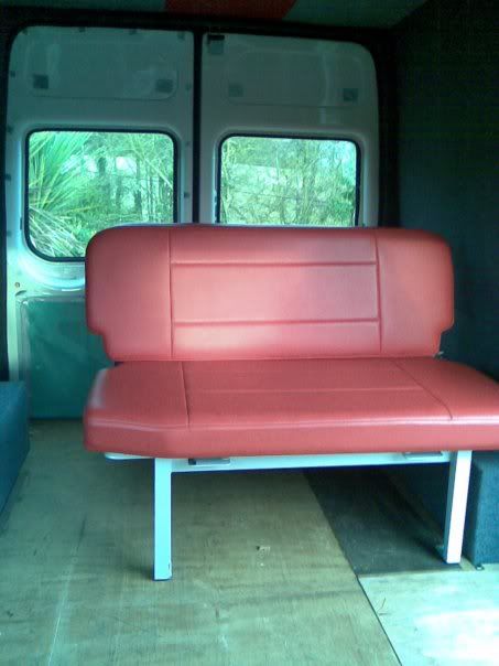

Breakdown Biker wrote:That's one lovely lookin van interior, well done :D 8) :mrgreen:
Wotcha plannin for seating/bed etc. :?:
Thanks! :D
We bought this:
from eBay, I think it originally came from bluebird conversions or somewhere like that and is a T4 bed. 3/4 width (113 cm wide) and just over 6ft long.
my camper conversion thread: viewtopic.php?f=58&t=59300

Postby Nadjenka » Sun Jan 17, 2010 6:47 pm
How difficult was it to fit Celotex in? Did you stick it on with glue or just cut it into tight shapes?
Great conversion btw, looks very professional 8)
Nadjenka
Posts: 1723
Re: MK6 Transit Camper Conversion
Postby rachelemily » Sun Jan 17, 2010 7:01 pm
Nadjenka wrote:How difficult was it to fit Celotex in? Did you stick it on with glue or just cut it into tight shapes?
We used glue - lots of it! We mainly evo grip/stick which you can get from b & q and we tried to cut it as tight as possible (however you could never cut it tight enough to stick without glue - especially on the roof, lol!)
It took us about 2 weeks to insulate the van - both of us working every night after work and most of the weekend so it was not a quick job however it's worth it.
