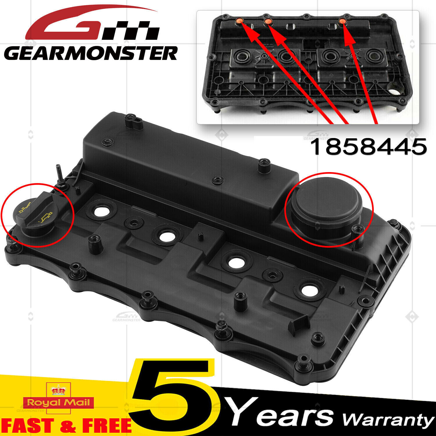

Could the orange thing be one of these -
picture huge - scroll around and look at the top of the picture, look at arrows, where they are pointing - it's 2.2 rocker cover on ebay
https://i.ebayimg.com/images/g/25EAAOSw ... -l1600.jpg
all the best.mark

They go in the rocker cover, they are some sort of one way valve for the crankcase ventilation.

Yes it could one if those as there are none in the rocker cover at the moment,
Will investigate a bit and try found the other two.

You guys were correct that they come from rocker/valve cover
The other 2 diaphragms were found resting in the head.
All three are damaged. Probably from driving the van with hole in piston 10kms to get cell reception.
I can also confirm that it was injector failure that caused the piston damage.
Are the diaphragms available from another supplier as well as Klifex?
Can purchase them from Ebay/Klifex and was wondering about our peoples experience with Klifex.

no idea, yesterday-when you put the first post up,..i just searched ebay for possible locations of that gizmo ..i started out looking at the breather system ..nothing, then moved to the rocker cover ..found in a couple of mins.
i was thinking you would have to buy a new rocker cover to get them.

heres the parts diagram ..cant see them on there

been identified
this is the proper ford parts
with part number etc "2060271"
you may find cheaper genuine ones elsewhere
https://www.ebay.co.uk/p/23022909924
