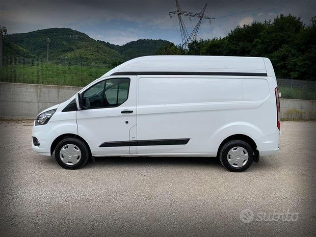

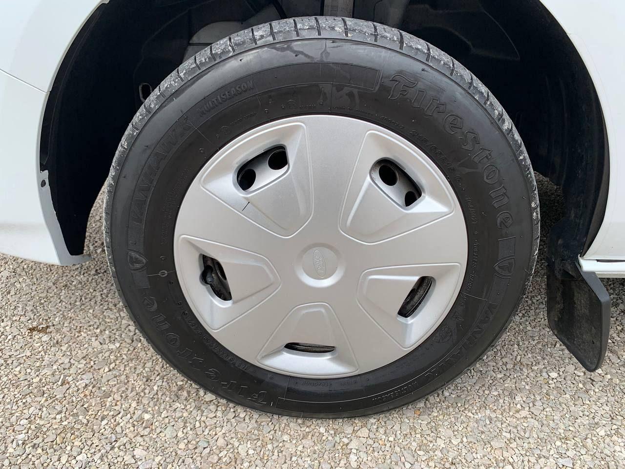

In Italy Transit Custom in base trim (which were the majority of those sold to companies and workers here) in the pre-restyling version and 2.0 engine(and sole 2.2 engine) were sold with 15" alloy wheels and a smaller tire outer diameter creating a lot of void in the fenders.
Like this photo:

My actually mk7 was a 300 lwb medium roof and came with 15in
Looked so weird and people kept asking why i put smaller wheels on ..... was first thing i changed
