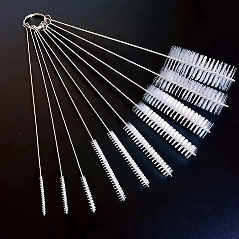

BTW .. try bottle cleaners from home bargains or poundland on the manifold ,,,
plenty of strong detergent - like washing powder 50/50 with boiling water
https://i.ebayimg.com/images/g/OgkAAeSw ... l1600.webp
some people say poundland oven cleaner ,(oven pride)... i don't know what effect it would have on the plastic ... so that may be good or a big mistake .. i haven't used it on plastic !!
all the best.mark
