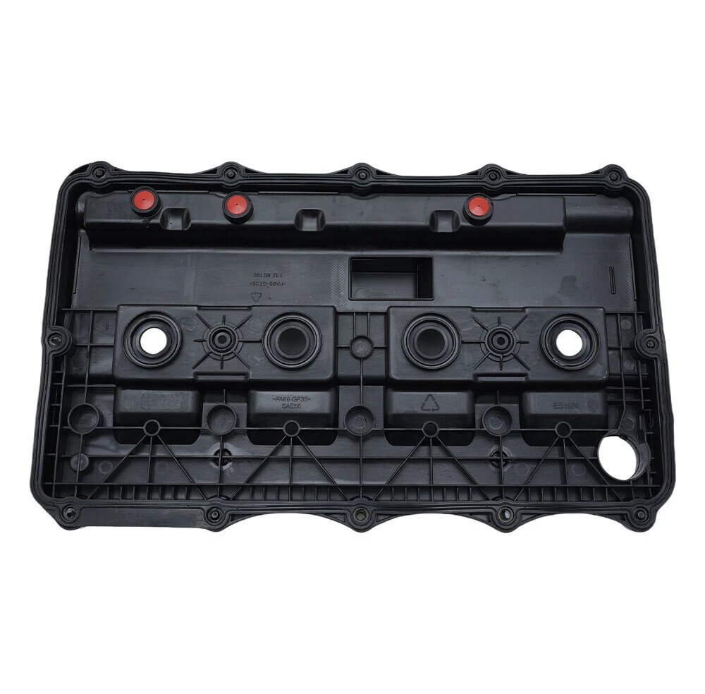

i would look carefully at the breather system though. not much written about this .. or parts named or labeled in the part diagrams ... but places to look are any pipe work coming out of the block or cylinder head/ rocker cover that are connected to the boost pipes or air filter , the rocker cover itself has a chamber in it .. that can get plugged up .. the rocker cover also has small orange rubber one way valves that can and do fall out -
https://i.ebayimg.com/images/g/UYwAAOSw ... l1600.webp
-- what effect this has i don't know but it cant be good.
