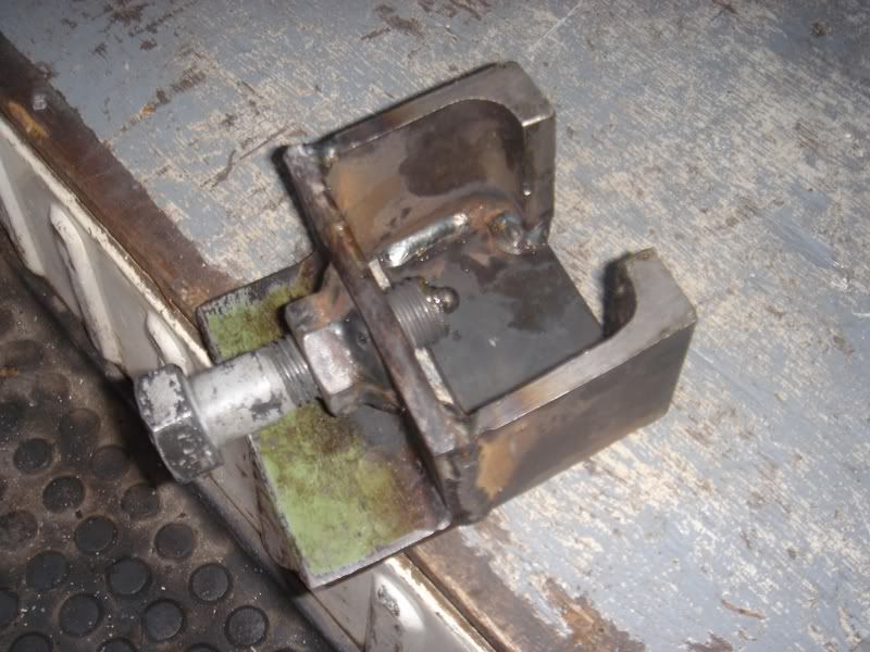

the only thing i'm short of now is the actual drop arm for the non pas box - i have one connected to a box that i need to split but i can't find my puller :evil:
all i have is this photo :( :lol:
