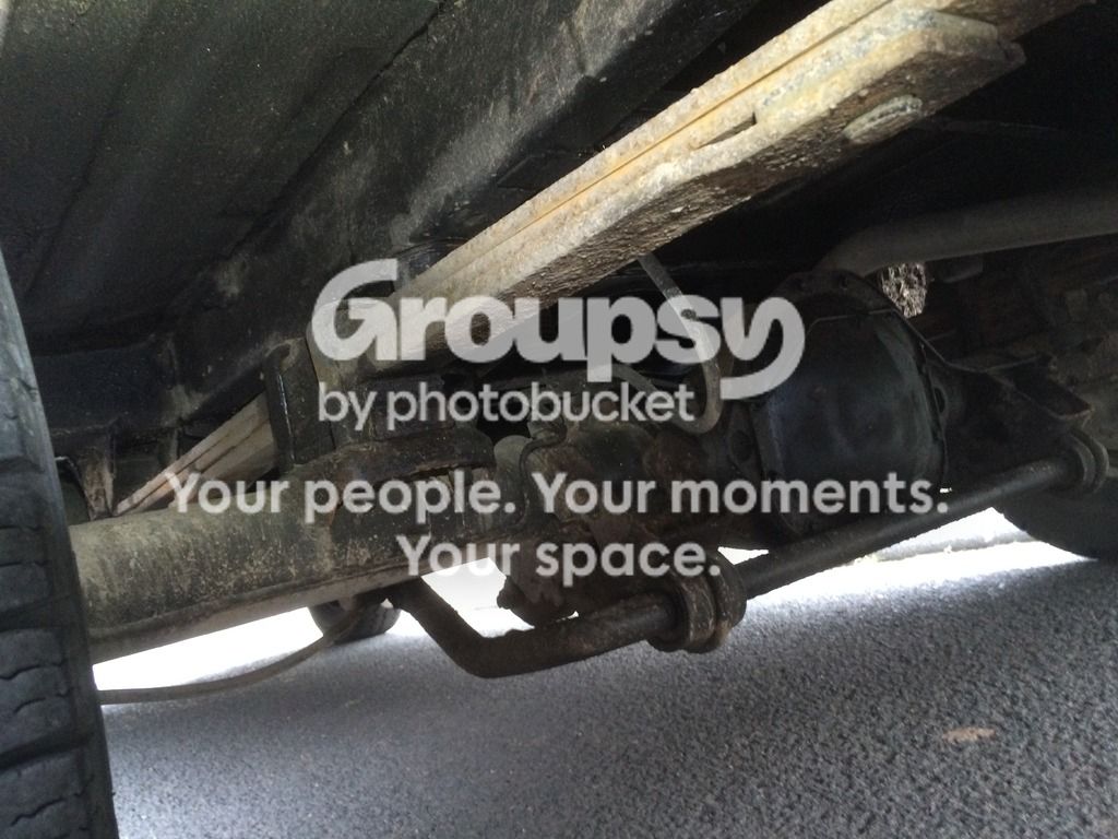

Happened in Mongolia, probably because of too much twist on the front axle. There must have been a crack in the spring which later caused the breakdown.
The Kia Bongo spring is straight forward, only minimal (1cm) difference in the center bore.
Now we changed to differnt leafs, as those Bongo springs wouldn't have lasted long. 4 leafs now in the front.. Car is much higher front than rear now and is quiet bumpy but will last. Front shocks are now welded Rancho RS5000 offroad rear shocks with the upper part from the old transit shocks ;-)

About the stabilizer bolts: due to the holes in the mounting and human logic it is possible to but the stabilizer in two different ways: to the front or to the rear bolts of the engine-mount. I don't remember how it was originally, but I changed it to the front and it seems to work much better. Also the 4 leafs of front springs are not allowing a lot of axle-wrap anymore, what is good for stability. Anyway, the suspension is a lot too hard and bumpy. I will need to change the springs in the front again when I am back. Also the bump-stops are too far away from the frame, which could cause a breakdown again. Though this should not happen, as the springs can take a serious lot of load now. The welded Rancho shocks are performing quiet good so far on the front, much better than stock.

Just lately worked on the van and it will be on the road again soon. As we removed the bushings from the KIA leaf-springs and left just the rubber, over time the frame worked itself into the spring. That's why the metal around the screw-hole is conical deformed and therefore the new original leaf-spring wouldn't fit anymore. How to solve that? Well, after some thoughts some parts of a spring compressor and some solid metal plates did the job as you can see. Afterwards the springs fitted kind of nicely..
If anyone would ask: Those 2-leaf springs are created by a leaf-spring factory, I ordered an original Ford Transit spring which should be supported by another leaf (200 €-bucks each). That's what came out. I will see how the whole geometry will work out now, I hope better! Only problem I see is the bumper, which I might modify.
I lifted the stop bumper of the leafs a bit, as the offset proofed to let the tires touch the wheel arches and destroy the tread pattern in extreme situation. That's why I wanted the bump stop to prevent this problem.
