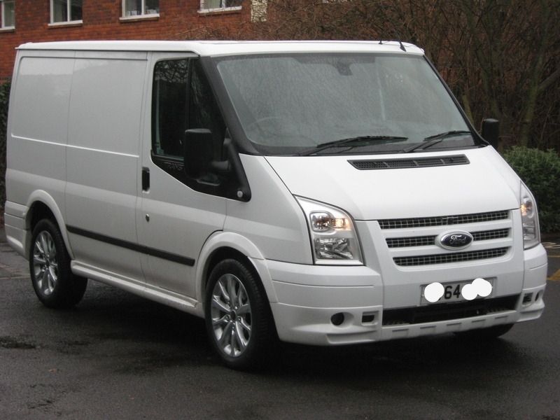

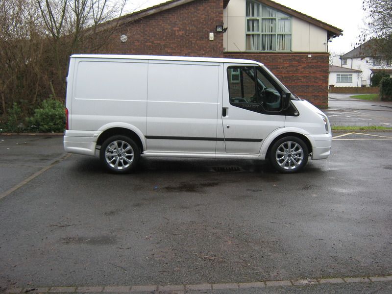

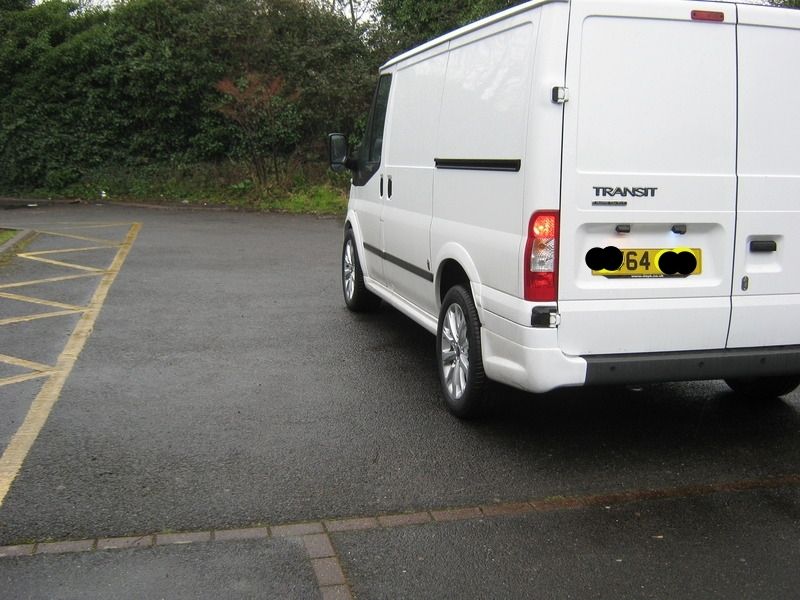

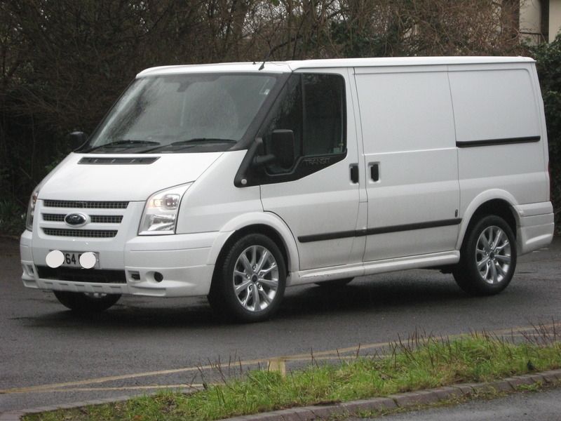

Sorry for the delay lads....got them on today, along with a sport kit.

They look great mate. What size tyres are you running and am I correct in thinking that they just bolt on, the stud pattern and offset are the same aren't they?
northwaleshaz
Posts: 109
Joined: Thu Nov 24, 2011 8:19 pm
Re: Custom sport wheels
Postby Kevsit » Sat Feb 20, 2016 8:05 pm
Tyres are 235 50 18.
These are a tapered nut fitment and not flat seat.
You need a set of tapered or cone seat nuts to fix them to the hubs.
But yes, they are same pcd, think ET is abit different, and they go straight on.
I am glad i went for them instead of the mk7 sport wheels, brings it more up to date.

Yeah I'd does make it look nice and modern. I still haven't managed to find a set of sport wheels so I think I'll have no choice but to go for these - I definitely like them 8)
