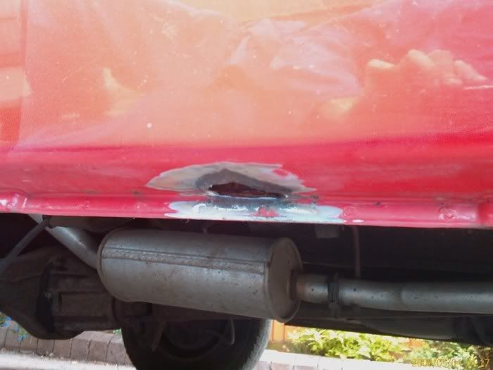

only cleaned the rust out of the right hand side so far.....the other side is worse.... :!:

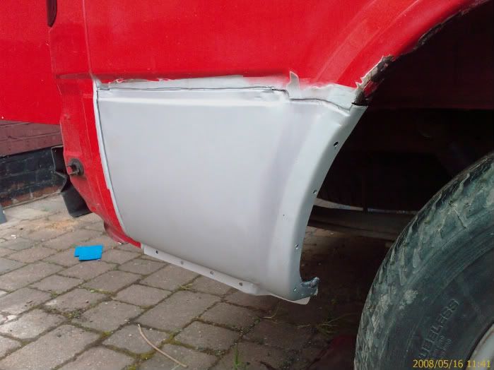

lower rear quarter.....

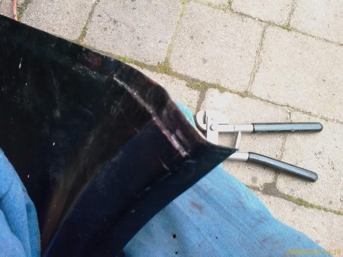

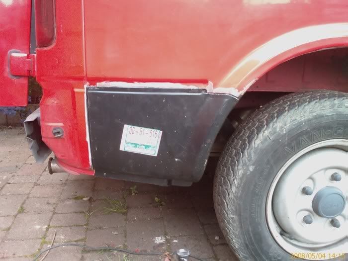

new panel trial fitted....
edgesetter helps get the fit right...
take note int :lol:

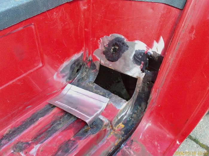

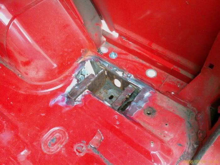

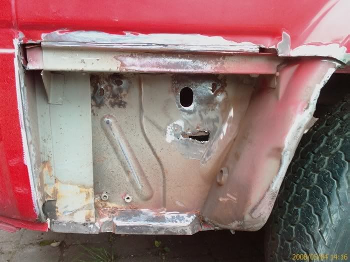

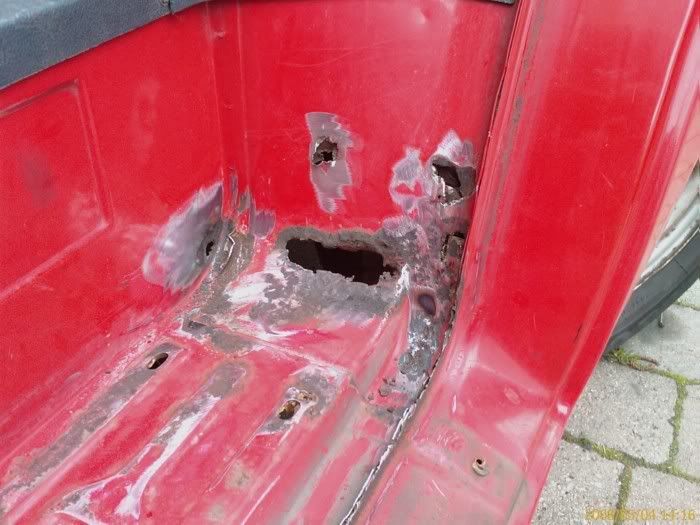

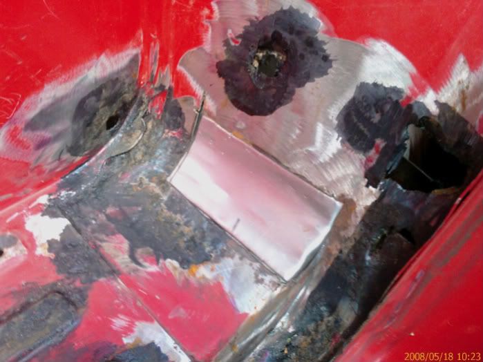

hole on the inside ove the spring hanger outrigger....
lots of small holes....

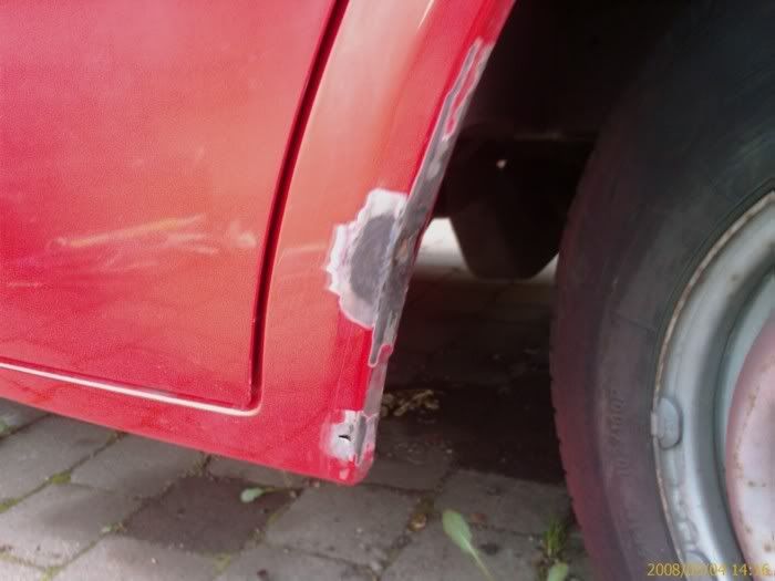

and an odd one, rusting from under the paint but no visible hole in the paint inside or outside :!:

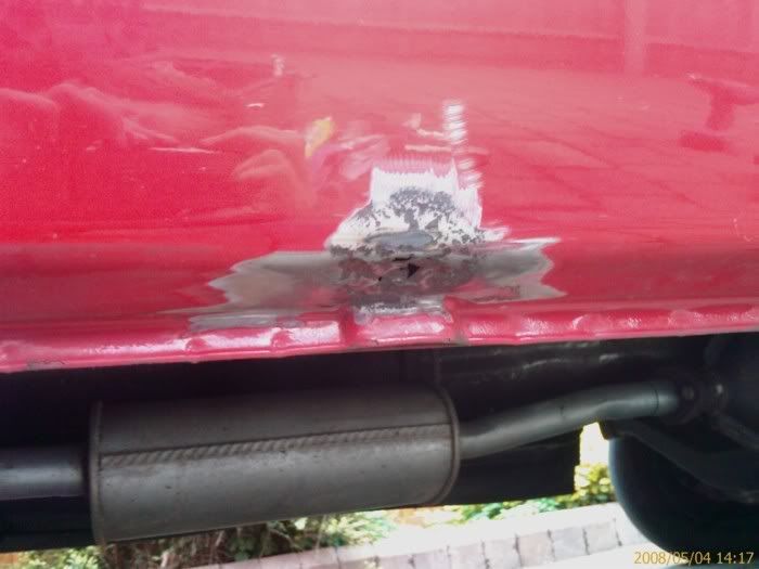

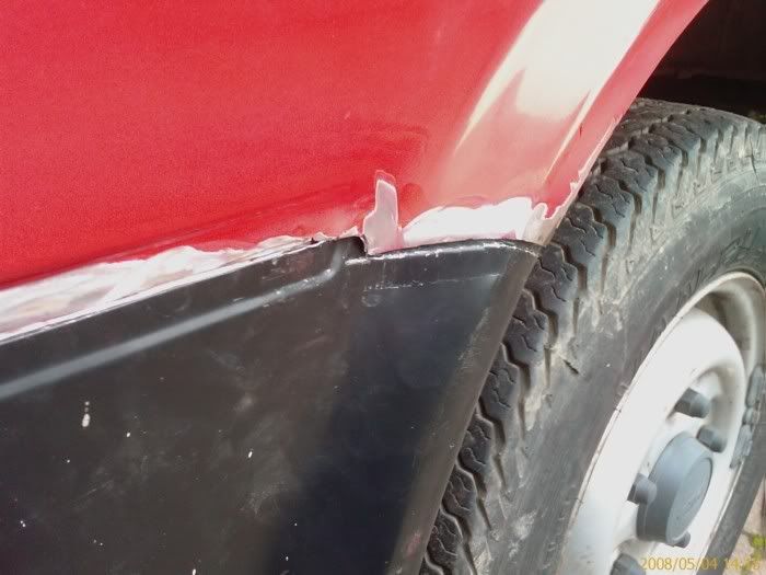

front arch, bit of surface rust and a small hole caused by the mudtraps....i mean mud flaps :evil:
and the step......sad face :lol:

Postby Gavin » Fri May 16, 2008 11:57 am

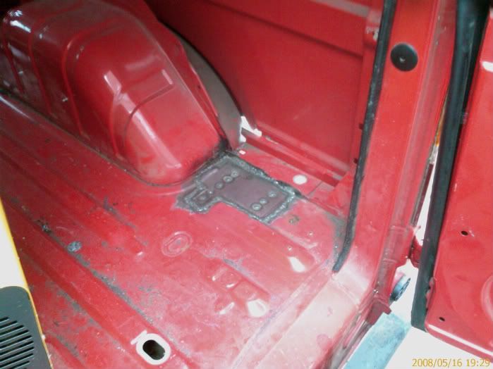

lower corner ready for welding. all primed inside and out with weld thru zinc etching primer, inside the rust has been cured painted and patched, and then painted over again. going to seam weld the top edge and the back edge, the bottom and the front have been drilled and that will all be plug welded and ground back.

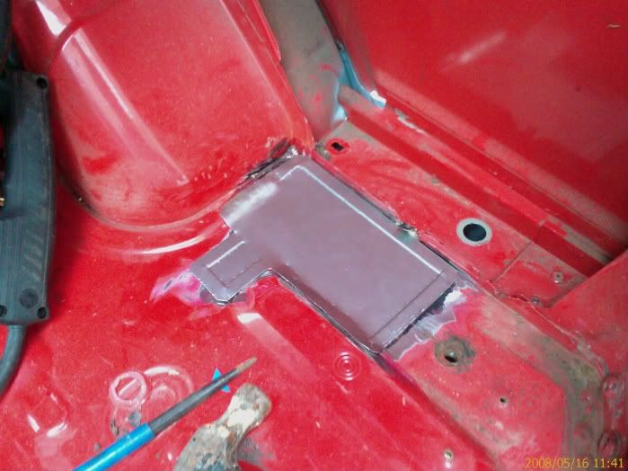

inside i've cut and shaped this panel, still need to drill some holes to pick up the spring hanger outrigger and will plug weld these. The edges will be seam welded, then i'll use some brushable seam sealer and paint it all red like its supposed to be :D

not so happy with the welding, bought a new reel of fluxed wire and it would go fine then a bit splattery on the same strip of clean metal. ive found this before with SIP reels, sometimes it seems the flux is intermittent :?
still, plate inside is done, im tempted to grind down the plug welds to neaten it up but its going to be boarded over anyway, so maybbe i'll just paint and seam seal it...

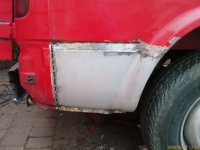

Postby Gavin » Sat May 17, 2008 1:01 pm
welded the lower rear panel on this morning, ground it all back.
the rear edge ive just stitched and will fill with sealant or filler, originally it was spot welded on the lip inside, but as a repair panel theres no way to do this!
i made a mistake, drilled one of the plug weld holes at the bottom over a drain hole, so to fill it o flattened a bit of 15mm copper tube and shoved it behind the drilled hole and filled it with weld. the copper wont stick to the panel or the weld, so when i was done i just took it out and the panel hole was nicely filled.

Postby Gavin » Mon May 19, 2008 10:17 pm
i could probably get away with a few coats of filler primer on the seam, but i will stick some p38 on it anyway.
i got the front step welded up over the weekend, shaped and edgeset pieces as before.
im not liking this new reel of wire at all, just cant get any consistency with it :( ive always (like 18 years since i started welding!) used flux cored stuff but im thinking about getting a bottle and having a go with mild steel wire instead....
sprayed both the step and the rear corner up in primer for now, will get round to filling and finishing later, right now im on a deadline for the welding, 3 weeks to go. still got a couple of patches to do on the cill on this side, then theres a couple of patches in the rear crossmember and on the other side ive got the whole rear arch panel and the cill under the door..... :(
