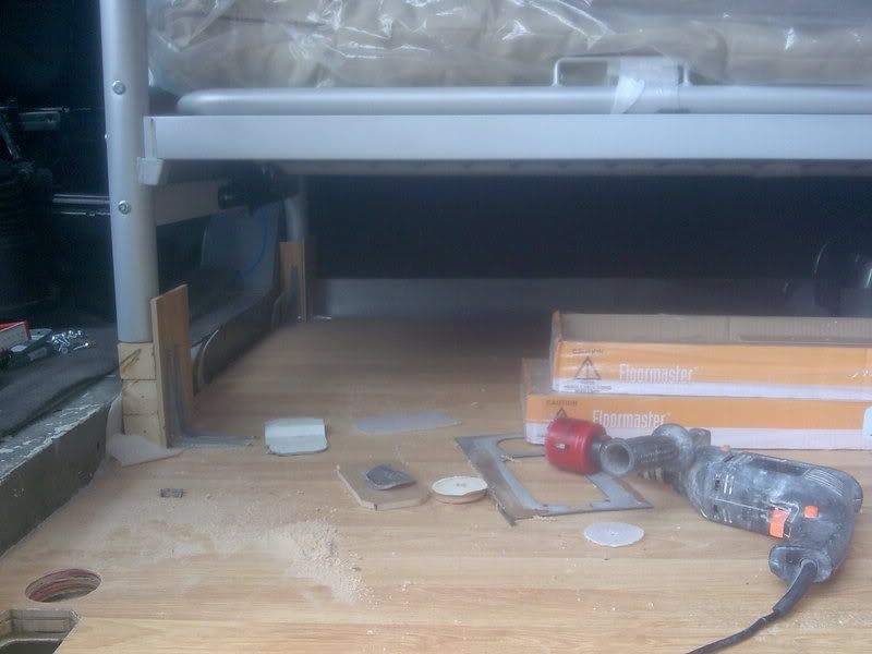

Postby nitroman » Sat Mar 07, 2009 1:39 pm
cut out floor to fit carver 1800 gas heater(these are just a fit under the van chassis bettween the rails.......
removed casing for refurb but its in...
started to case the bed settee and create stoage underneath and frame for where sink goes etc
