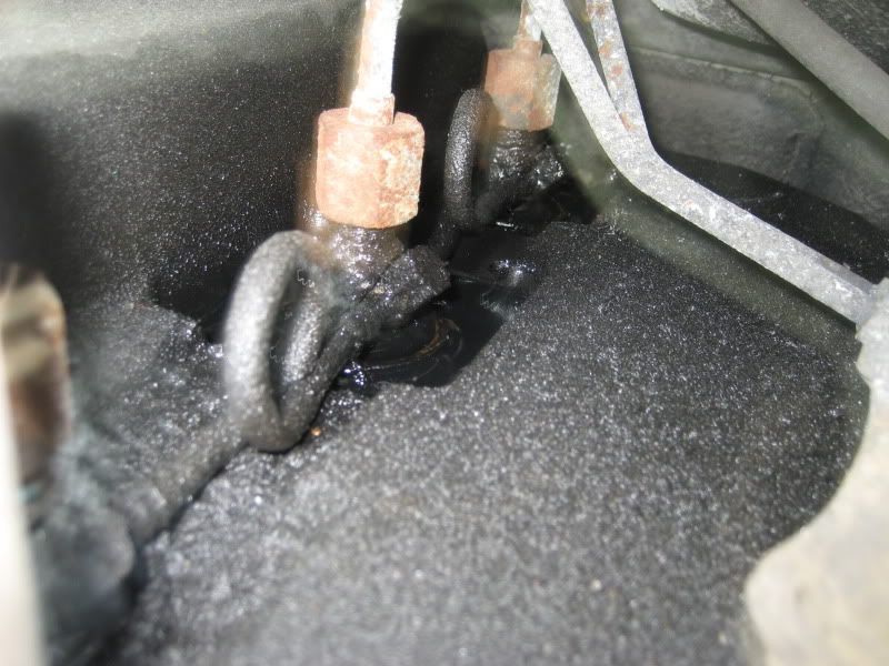

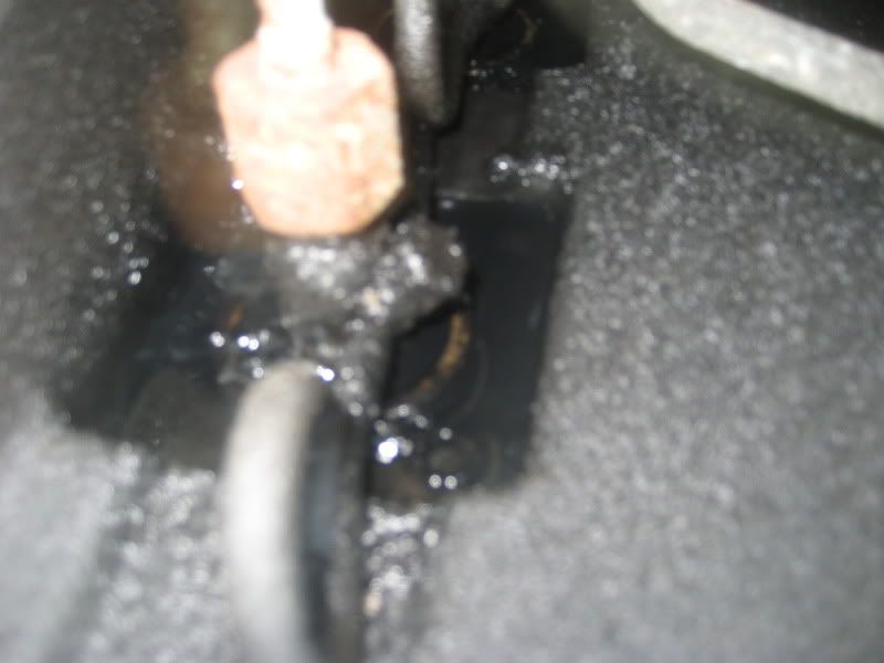

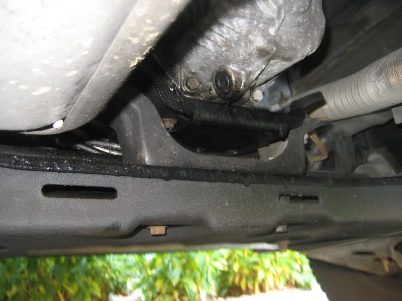

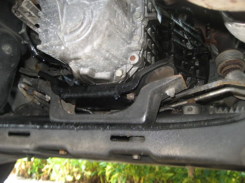

Recently I've discovered oily stains on the place I always park my Transit, so I took a look underneath.
then I opened the hood to find the back injectors like this
what could this leak be? Is it an urgent repair and will it be costly?

Those aren't spark plugs, they are the diesel injectors and it looks like a diesel leak.

MrMPuk wrote:Those aren't spark plugs, they are the diesel injectors and it looks like a diesel leak.
:oops:
how can i fix this?

Postby belly » Fri May 28, 2010 6:18 pm
Could it be injector seals if they've been out before ?

Postby MrMPuk » Fri May 28, 2010 6:18 pm
I'd start it up and see where it's leaking from first.

Postby belly » Fri May 28, 2010 6:21 pm
if it's injector seals quite easy but you still have to take the injector feed pipes off to slip the old ones off and new ones on! then the toughest bit re bleeding the bitch :x

Postby belly » Fri May 28, 2010 6:23 pm
Looking again i think Mike is right and it's diesel :( quite clear for oil !

Postby artru » Fri May 28, 2010 7:03 pm
could it be the bolts have shaken loose a bit and need to re-tightened?

Postby jacko1611 » Fri May 28, 2010 8:02 pm
hmm might b leak off pipes

Postby artru » Sat May 29, 2010 1:46 pm
checked the bolts, they were tight, so it it'll be the injector seals, like you said

Postby jacko1611 » Sat May 29, 2010 2:30 pm
looks like a puddle of diesel to me more than injector seals.
