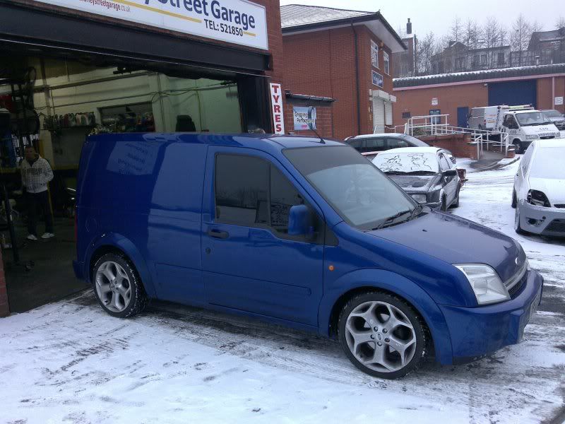

Can anyone tell me what colour this is :
Is it Performance Blue ?
Anyone know the colour code ?
Is it pearl, flat or metallic paint ?

I thought it was PB.
Vale will know.

It's looks like pb which is pearl
Just have the colour made without the pearl

That's what i'm doing, the paint shop said that it's water based paint so will be slightly more expensive.
no probs, that's the colour i'm having the van painted.

All colours are waterbase and solvent base.
All large bodyshops / refinishers have to use waterbase that's the law.
It doesn't matter if its blue green red yellow silver basecoat gloss etc it will be waterbase
However if it a small bodyshop/refinisher like me then they can use solvent based paint
As for cost watetbase is more money

Thanks, i've been told the colour code is :
OEM Code : 3CVCWWA
User OEM Code : j4
is this correct ?

Right colour code is:-3cvc
But there is a BIG BUT by removing the pearl it will change the colour to a lighter blue.
That colour costs me £50 a litre
