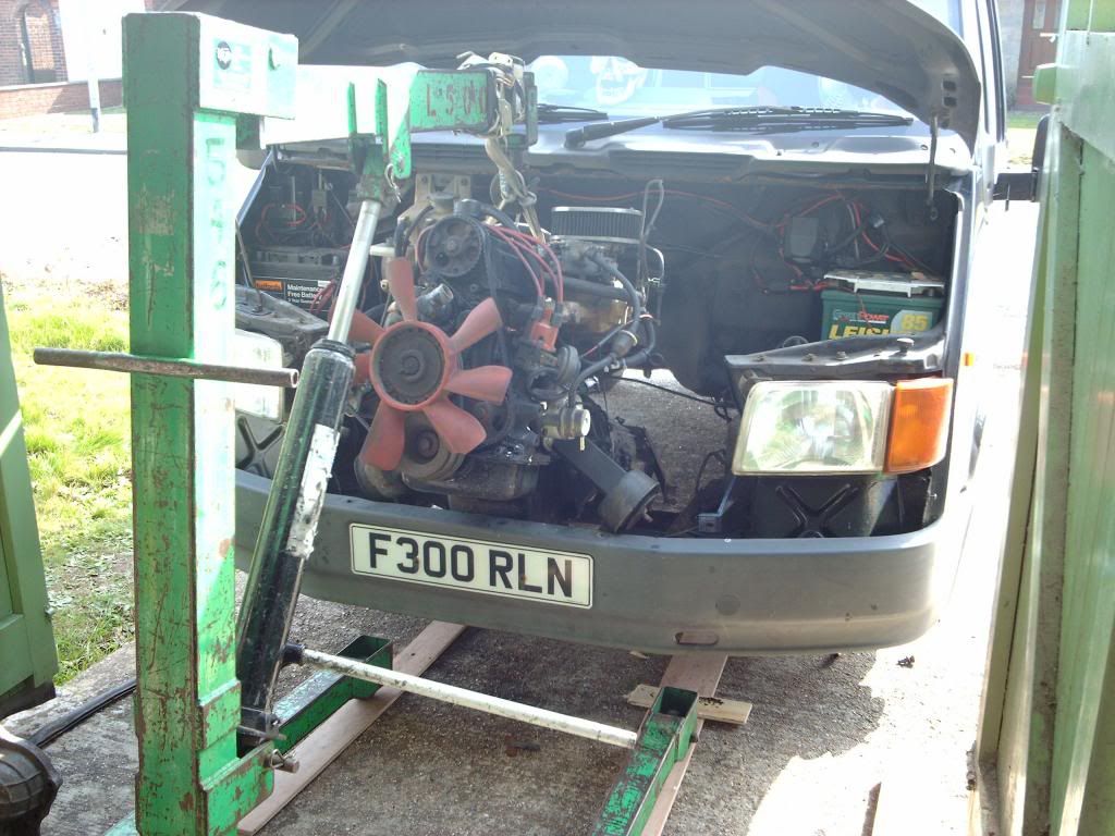

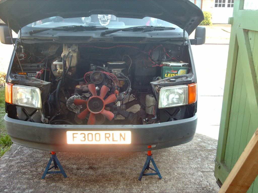

Well, started on the conversion, today preparing to remove 2.0 Pinto and auto-box in one lump
Took all day removing all attachments.... exhaust took over an hour to remove (when I fitted it last year I meant it to be secure), auto cooler pipes were a pain, but now engine and box are ready to be lifted out in the morning, just sat on its engine mounts and an axle stand under the gearbox.

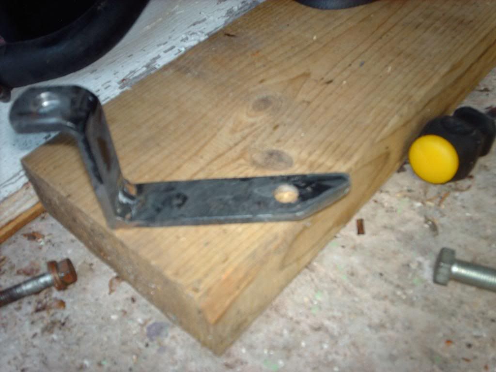

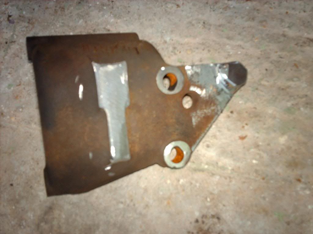

Have modified the mk5 power steering bracket so it bolts direct to the engine and not on an adaptor plate:

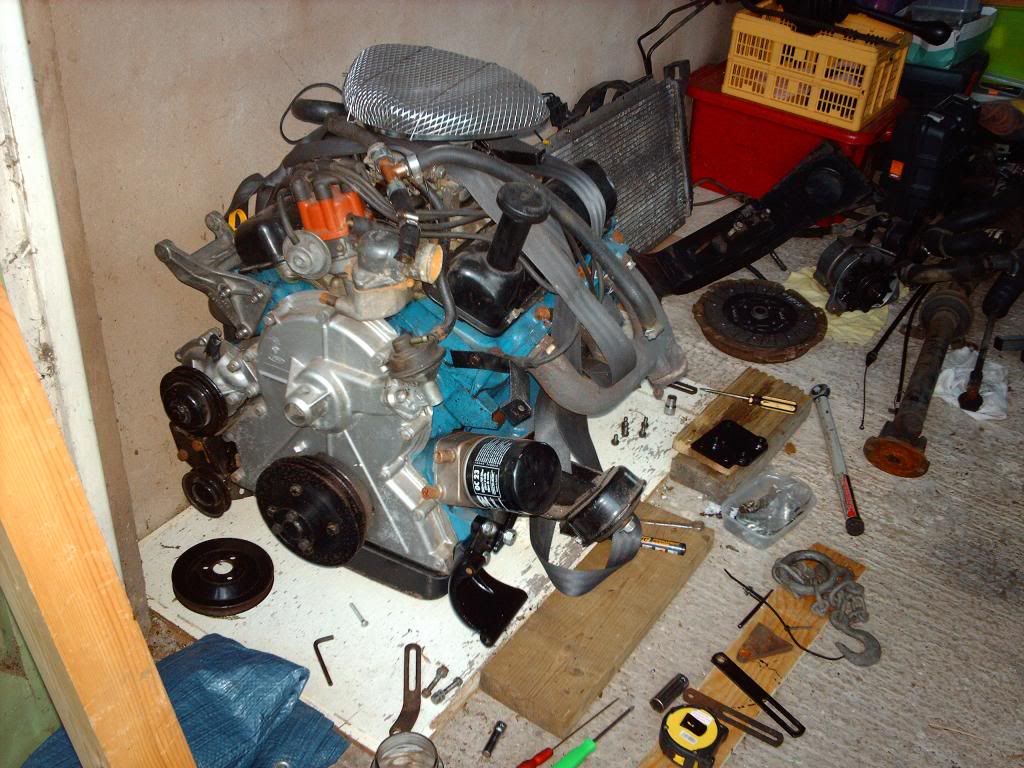

And The Essex V6 waiting to be worked on and installed:

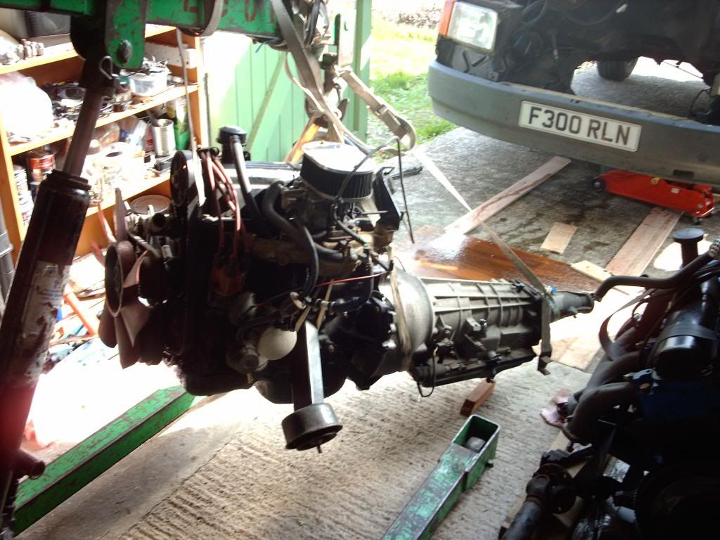

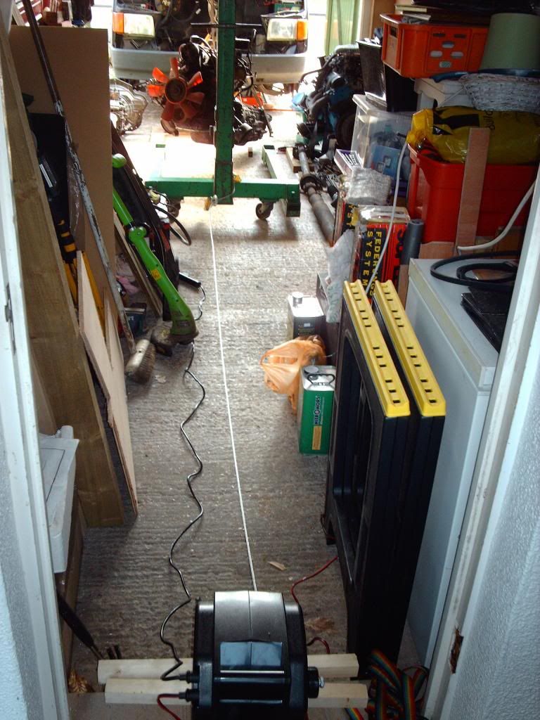

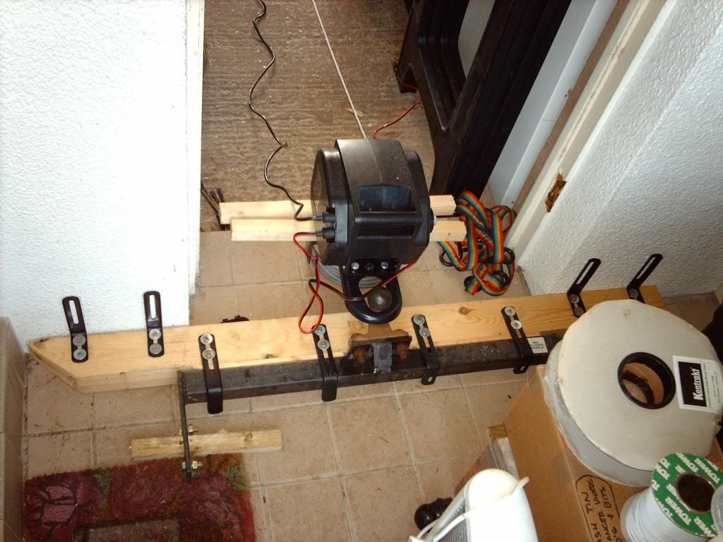

Finally lift the engine / gearbox out:

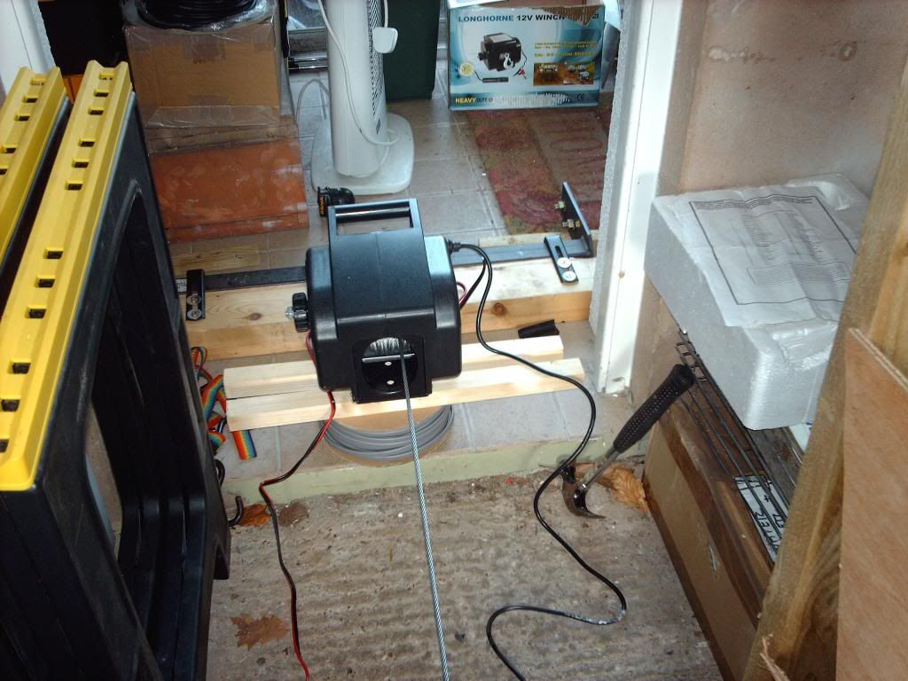

Due to the driveway sloping uphill into the garage and being on my own and the weight of the engine / gearbox combined had to use my 12 volt winch with homemade towbar support and the garage back door frame :D
But at last the engine and gearbox are out and safely in the garage with no incidents:

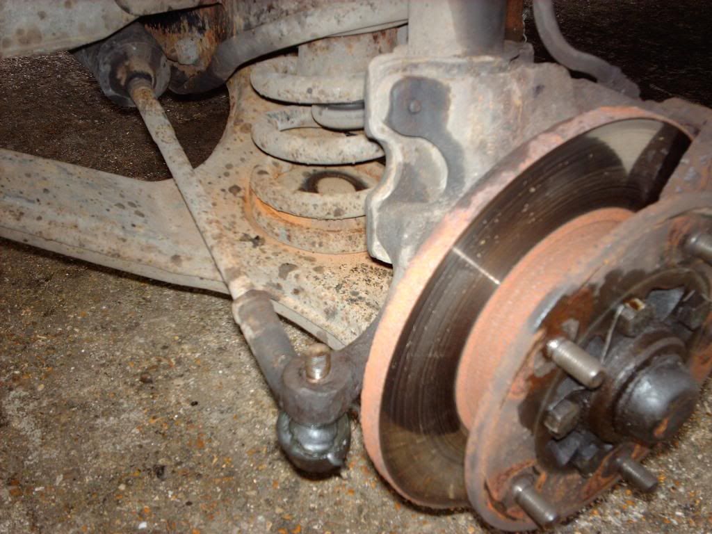

Thought whilst waiting for the GUNK to soak in would remove the manual steering rack :shock: Got drivers side nut undone and separated the ball joint with a splitter, came to the passenger side, couldn`t even get nut undone, spent about 40 minutes with the 22mm spanner and a lump hammer, then switching to the 21 mm spanner and the lump hammer and finally removed the nut, however cannot separate the ball joint, am using a 18 inch fork ball joint splitter and lump hammer and gallons of WD40 but the joint will not split, so after an hour of trying to split the joint I have given up for today, need food and some beer :D will attack the track rod end again tomorrow.

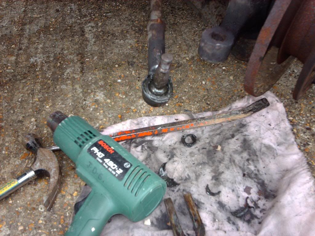

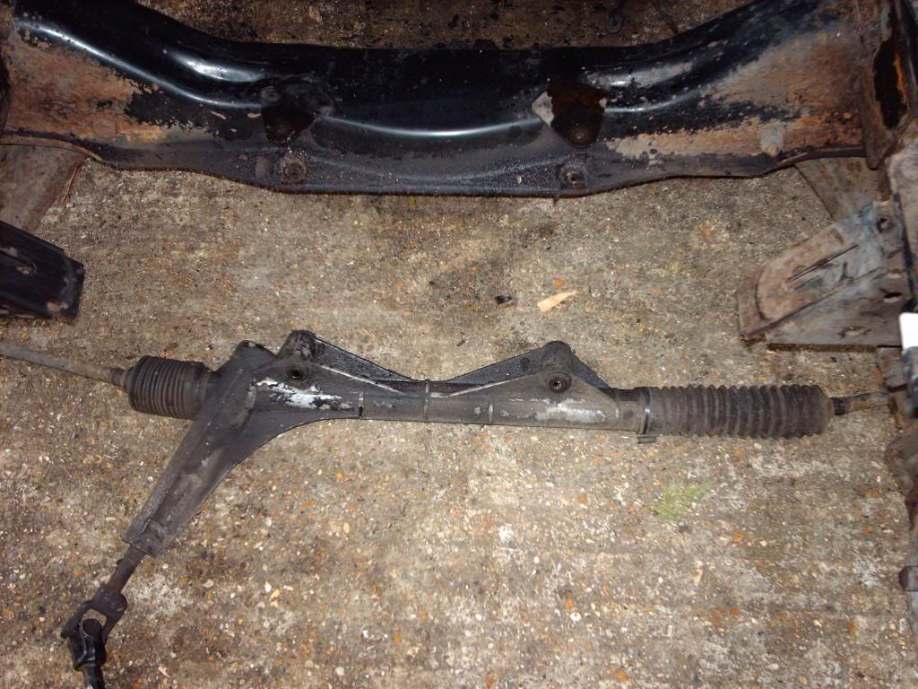

Well, went out this morning to attack the passenger side track rod end ball joint which is one of the most defiant ball joints I have known:
So after 30 minutes of hammering, bashing and swearing :lol: decided heat was needed, but alas cannot find my portable blow lamp, so decided to use my trusty old Bosch heat gun, after 10 minutes of blowing hot air on the thing and one final swing of the lump hammer .. pop .. the joint separated:
A wave of happiness and joy flowed through me :lol: well thought thank f*** for that.
Manual steering rack now removed and can at last progress:
