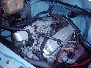

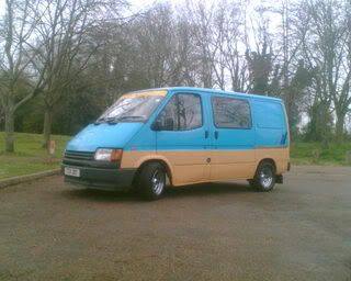

its about time i started one of these threads so here goes.
for those who dont know im currently modifying a mk3 transit 100 swb van.it runs a 2.8 v6
cologne engine and 5 speed type 9 from a capri without the fuel injection as this was easier to fit, and at present it has 6 inch fronts and 7 inch x14 rears with 195/65 and 265/50 tyres.

theres a mazda mx5 gearbox on ebay right now which fits the ford v6.....
is that van lowered? or is it just the effect of the wheels and tires?
Gavin
Posts: 2012
Location: hertfordshire
Re: BROWNYS V6 MK3
Postby BROWNYS V6 » Sun Apr 20, 2008 7:42 pm
wheels and tyres do help but front has had 1 coil removed. :lol:
