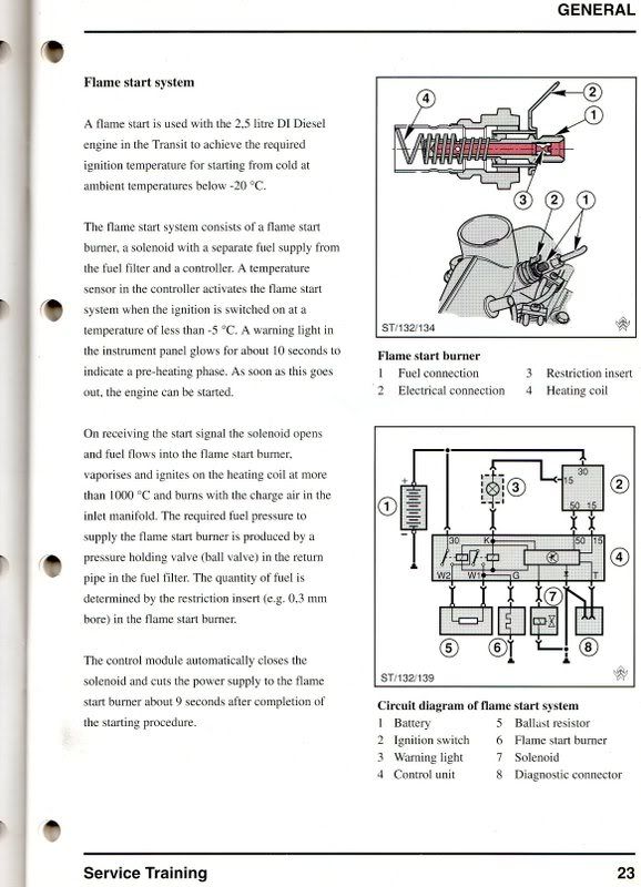

Postby Frag » Mon Jan 12, 2009 3:19 pm
Here you go :D
Frag

Re: Problem with pre-heater of starting sistem
Postby umek » Mon Jan 12, 2009 11:26 pm
:shock: :shock:
Perfect my friend, now i know how it works
