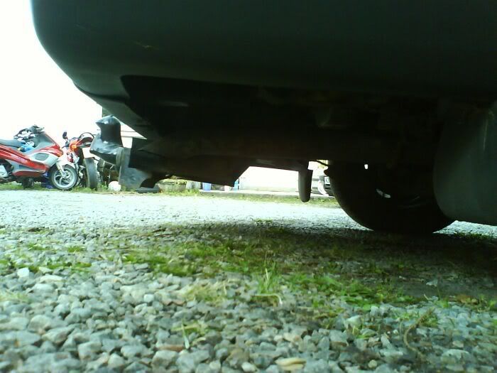

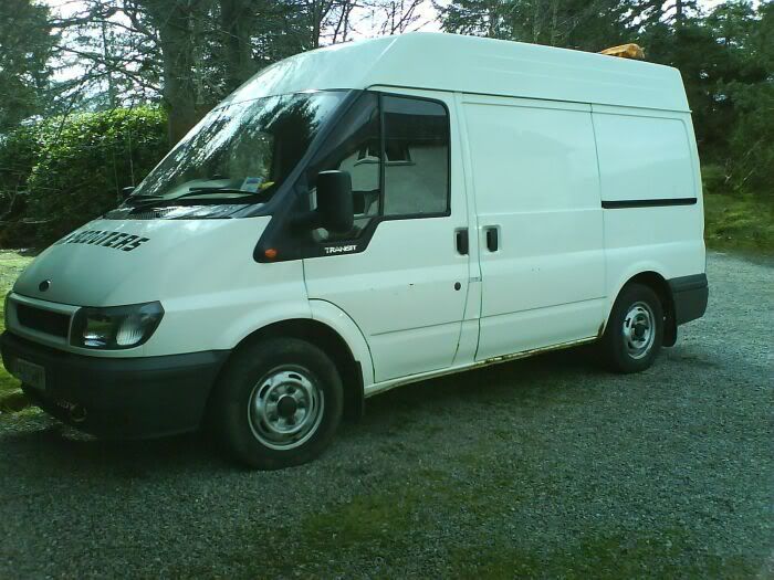

Postby sc_BK » Sun Apr 29, 2007 10:55 pm
X reg, cannae really tell in these pics but it was low!
