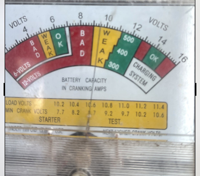

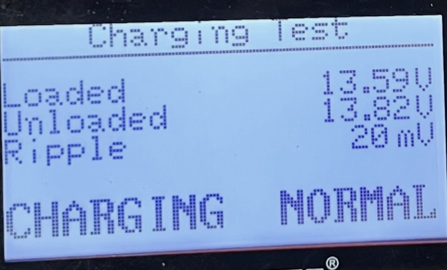

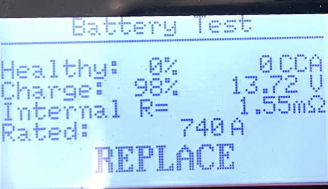

Results are in:
Alternator is fine
Just one of the two batteries bad.
Battery test
Alternator Test
Old fashioned drop test.

Postby metalworker0 » Mon Aug 10, 2026 4:25 pm
well the only one there that says its bad is the analogue drop test .. the digital is saying replace with no measurement results of the amp hours only what it should actually be .
perhaps alternator has intermittent fault and over charges
seems odd that battery would heat up if fooked
anyway .. your drop test says otherwise, so replace
but do some more alternator tests strait away after replacing batteries with strait forward digital volt testing.
ive driven round with buggered batteries for weeks .. they never got hot
all the best.mark

Postby reevco62 » Tue Aug 11, 2026 5:20 pm
Fitted new battery today all running well took it for a 20 mile run with OBD11 plugged in and alternator held a nice steady 14.3v to 14.4v and never fluctuated at all
