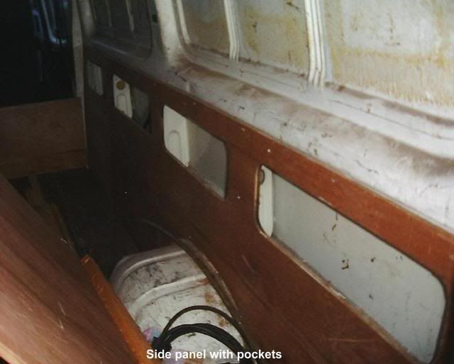

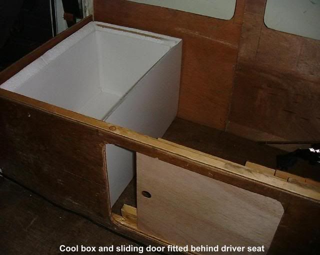

Storage or cubby holes where cut in to the side panels on both side of the van for extra storage, just deep enough to be useful without having to use the main boxes when fitted. These will eventually lined with carpet. A chillier box was made from old scrap white double-glazing door infill panels. After mitring all the corners, the parts where glued together to make a tough cool box 28mm thick, perfect for storing food stuffs along with ice blocks.

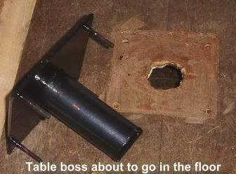

With two long storage boxes down both sides, being used as seating and as a bed, a table had to be cut make the bed extension, when I saw the cost of a ready made table leg and fittings, I thought “no way”. So home it was. Very simple plate with bolts and a tube welded on and then sunk in to the timber floor to make a smooth finish when covered with lino
